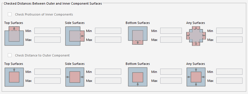

    @agroni Perhaps you can figure something out with Rule SOL/226/3.0
    agroniA 1 Reply Last reply
    • agroniA Offline
      agroniA Offline
      agroni
      replied to A Former User on last edited by
      @cminde
      I already tried that. It works best for doors and windows, but for such bulky components as I have, it does not fit the criteria.
      It checks space requirement on the front, based on the parameters. On the back it is the same thing, just mirrored. And the sides can be checked only inwards of the componend and not outwards.
      I have also thought about SOL/234/1.2, but also again here I am limited to some sides and not all 4 horizontal.
      any other ideas?

          @cminde
          If I can model something physical for a space requirement, I don’t actually need solibri to check for collision. I could also do it directly in Archicad or even visually control in 3d if everything sits correctly. 🙄
          The advantage of such a rule would be of actually checking it automatically by solibri.
          Another case where such a scenario might be implemented is in server racks, where there is a space requirement in front, back and one side to approach it. Three sides with two up to three different space requirements.
          Can the @Solibrians throw a helping hand here?

              scripts are nice but in my opinion second hand craftsmanship. You could check this probably also with Galapagos, but that is not the point. The point is we should focus on Solibri as our main choice of a weapon 😉
              We already have SOL/234/1.2. If Solibri can actually check distances with this rule from obejcts in specific directions, it seems to me legit to create a new possibility to check specific values for all 4 sides (and upwards) as you can see in my first sketch. So my suggestions could be a new rule or an extension to the 234/1.2.
              TriPoint GmbH
              www.tri-point.at
                @agroni said in Minimum space requirement:
                You mean adding an alternative version of the rule which specifies the sides further into North, East, South and West (vulgo Front, Left, Right, …) direction?
                Well I think this, should be possible within the API, but what from your sketch and description it looks like you want to use the local coordinate system of the rotated object, …
                The biggest obstacle is to define the sides: what is front, left/right and back to define those 3 different values.
                … which somehow is a totally different story in terms of specifying the concept for such a rule I guess. Moreover, you wrote you want to calculate, optimize and not only checking it.

                  Hi @jsn
                  An alternative could be a solution to leave 234/1.2 as it is and no confusion arises.
                  You misunderstood me because I did not speak about optimizing the space. That would be a totally different task force for Solibri. That’s why I meant that those things could be done with other programs such as Galapagos.
                  What I am not sure is how to detect the element orientation. As I wrote previously, what is the front, side and rear?!? In my opinion, this information should come from the IFC structure. So far I was not able to find any entity or relation of space requirements and objects.
                      Well, probably because you described the task like the following in the first post, without giving much details.
                      I am trying to figure out a way to calculate the minimum space requirement around an object. (…)
                      So, from your other posts now I better know what you want to achieve
                      To sum this up simplified,
                      // you want to check your containers
                      // they have four sides
                      // 3 are equal distance x, and on the e.g. front they need more space, so x+y
                      An idea. Would it eventually be a possibility to use #226 with some modelling support?
                      You could use it 2x
                      // first to check for distance x on all four sides
                      // secondly, which checks for the extra distancy x+y, just on the front side - wasn’t there a possibility to do so?
                      Edit: Ok, this was just possible for walls and I think there is no other rule where you can just specify the fron, isn’t it?
                      So in my eyes it would be actually the best approach if #226 gets a remake where you can specify the checked sides of the component a bit better - it needs a new look anyhow as the description is very poor as discussed elsewhere …
