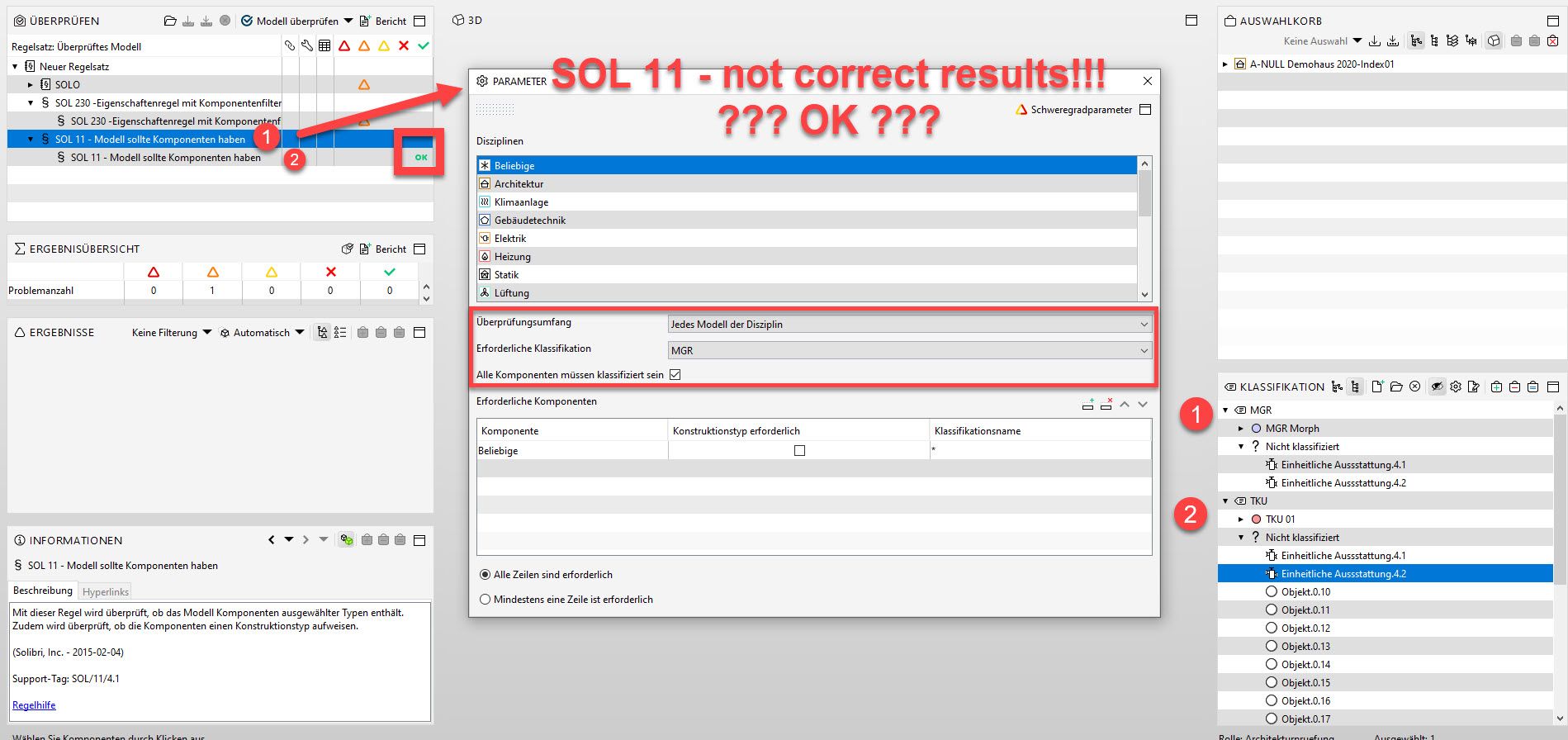

    Dear Solibri Team,

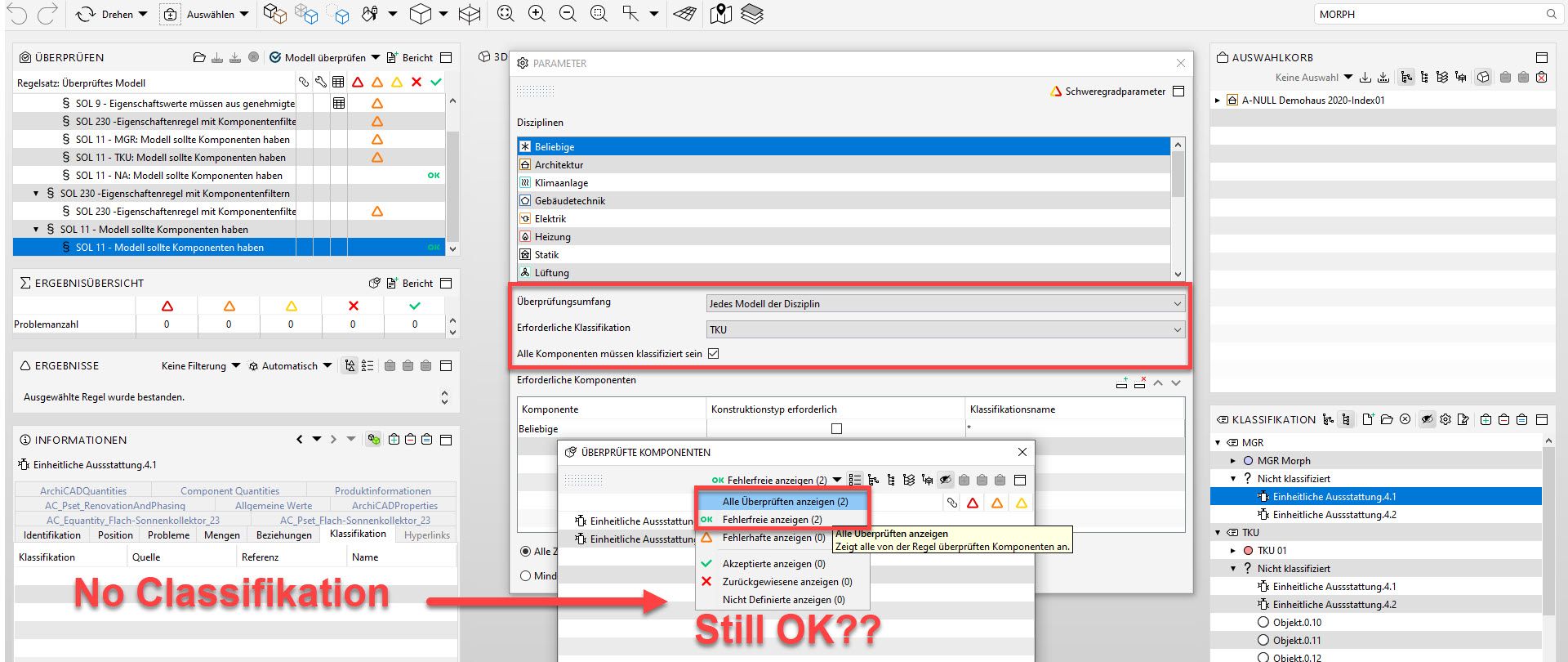

    I tried to develop a Checking if all the elements are classified? In my model, I had “Objects” and “Einheitliche Ausstattung”, of whom only Objects were classified in one of my 2 Classifications (MGR, TKU).

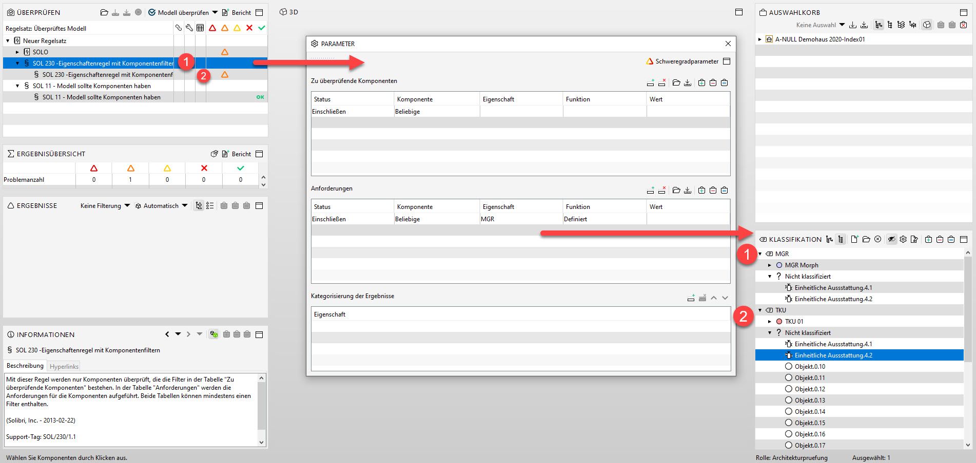

    I tried to check for classification using gatekeeper of the same rule, with first parameter classification MGR and second TKU.
    With SOL 230 everything functioned fine, but the same system using SOL 11 I had become an OK – which is a false result. In a single, not gatekeeper system, the Rule SOL 11 functioned fine, but for some reason not in the gatekeeper system. Even there are the Correct elements checked, they somehow pass the rule.
    See attached images and file.
