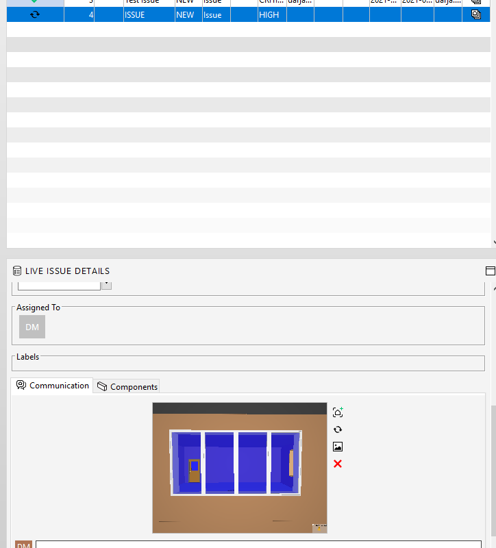

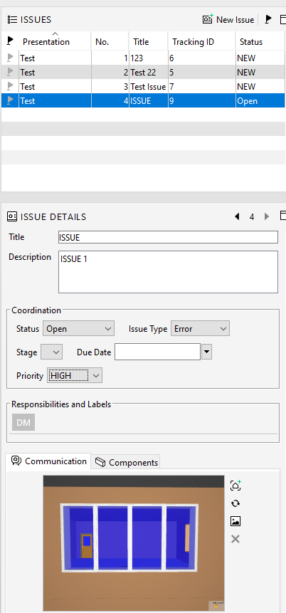

    Hello,
    I have a problem with pictures in BCF Live Connector as after synchronisation pictures just disappear. To reproduce what am I doing:
    2. I click on “Import Issues” in BCF Live Connector and I can see that the issue is being syncked and at that time the picture is still visible
    3. However after the sync is completed, the picture disappears. That happens every time with every issue. And I cannot click on the empty picture meaning that I cannot see where the clashes in the building appear.
    I tried but have not found any solution for that problem. The problem causes a lot of difficulties and double work that is why I would like to hear if anyone had the same problem or if anyone knows how to fix it.
    Thanks in advance!

                Hi @Darja,
                I have investigated the log you provided. It is a known issue with Trimble connect as they are currently in Beta phase. New Viewpoints are currently not being published to Trimble Connect as Solibri does not provide model information.
                D 1 Reply Last reply
