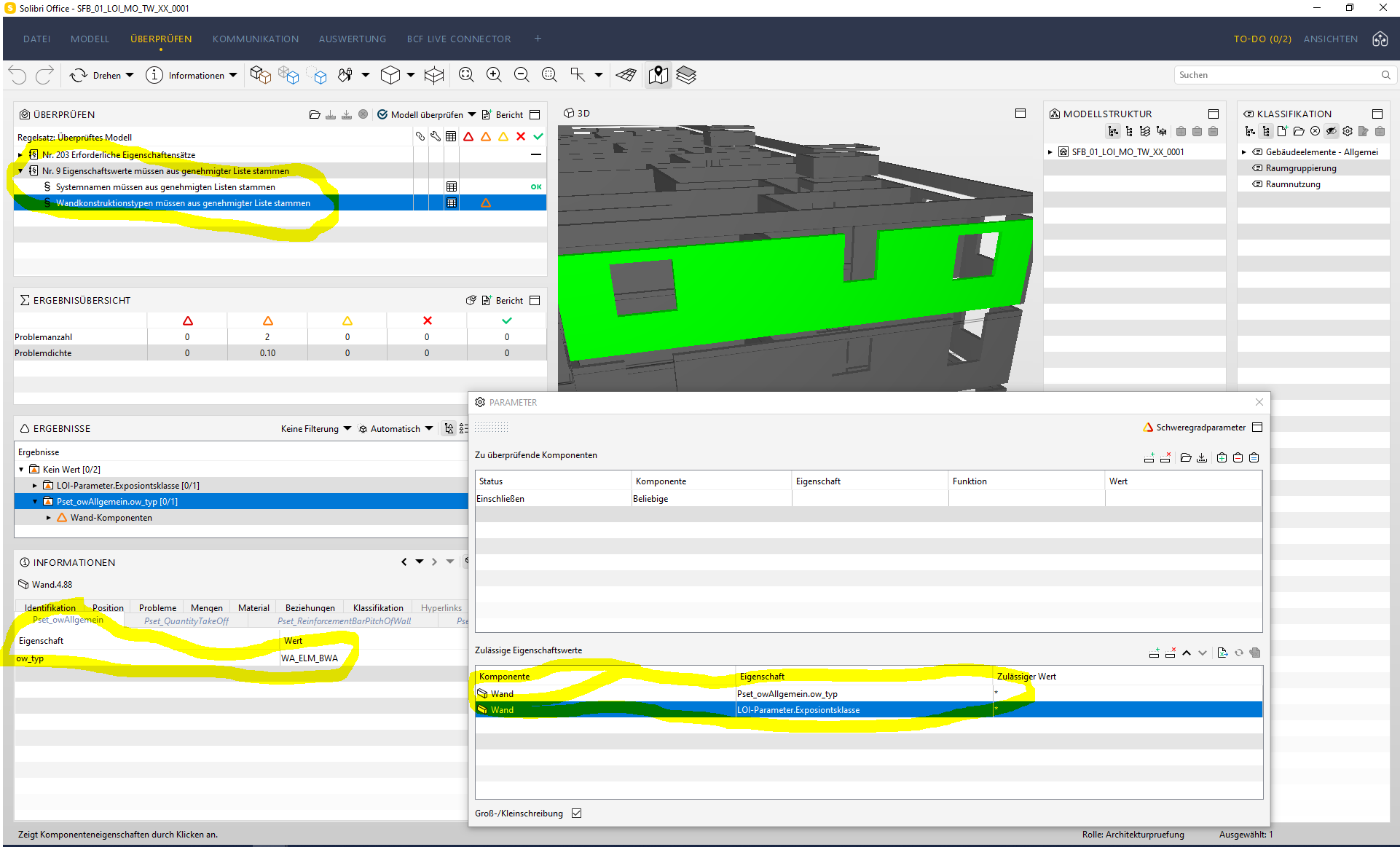

    Dear developers,
    what I am doing wrong ? It is a Revit export ifc2x3 file. All other PropertiySets are recognized except this one (Pset_owAllgemein) ?
    Any idea ?
    Thank you!
    Thomas

      Just quess that this could be a whitespace issue?
      You could open this IFC to text editor and see if there are white space in Pset_owAllgemein.

        @Matti-Kannala Thank you this is the problem!
