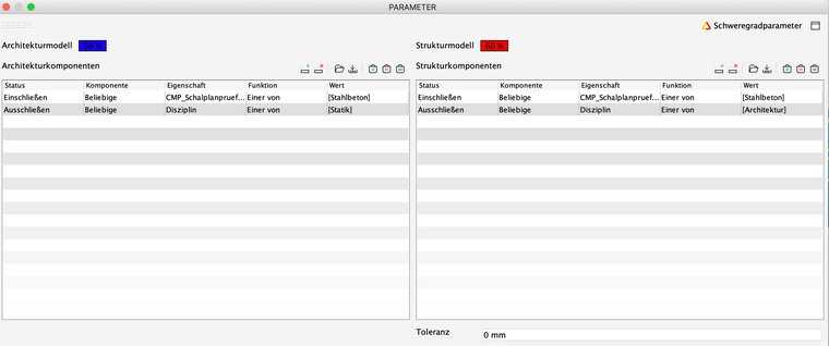

    Since the modelling methods differ greatly, I use a classification that refers to the corresponding materials (Concrete, Precast, Masonry, …).
    In the rules I then set that any components of a certain classification should be checked against the other:
    The classification is correctly assigned for all components.

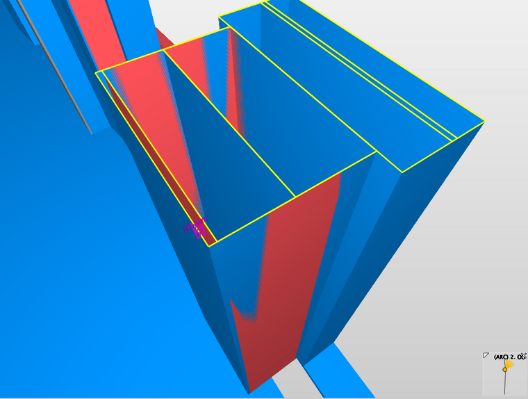

    In several places there are definite differences between the models, but Solibri does not find them. See this example, where the architectural column is 20mm bigger than the column in structural model:

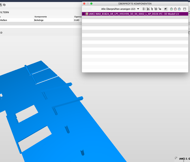

    The IfcBuildingElementParts do not seem to be checked – the columns of the facade are missing in the checked components view:

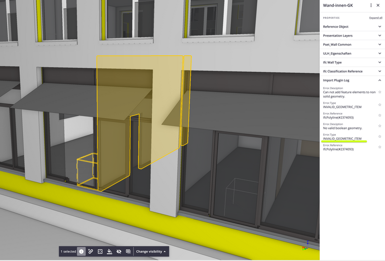

      Looks like an issue with invalid geometry:
      Can somebody confirm, that invalid elements are not checked at all?
