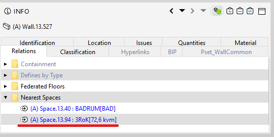

    I try to use the near space to classify my component for an ITO, but this was not an easy task as I had predicted.

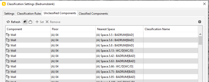

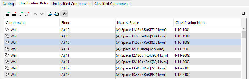

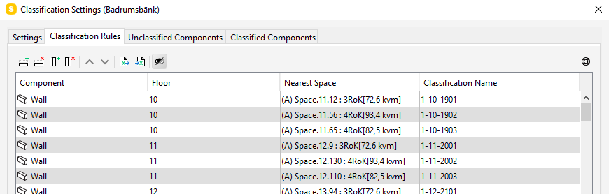

    I have tried to use the space name that is shown in the relations tab and classified as the picture is showing, I use the floor parameter so I don’t get components on different floors. More to come👇
    2cd48592-6383-4e8d-a853-d5b6d4c00337-image.png 01a93e13-bd24-4068-9671-c1e97dd9544d-image.png

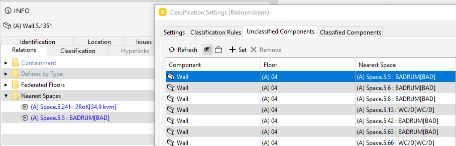

    but in the end, it’s 50% of the components that are unclassified even though the classification should work just fine, in my opinion ☺ Can you help me figure out how making this work a bit better instead of manually classifying each component?
