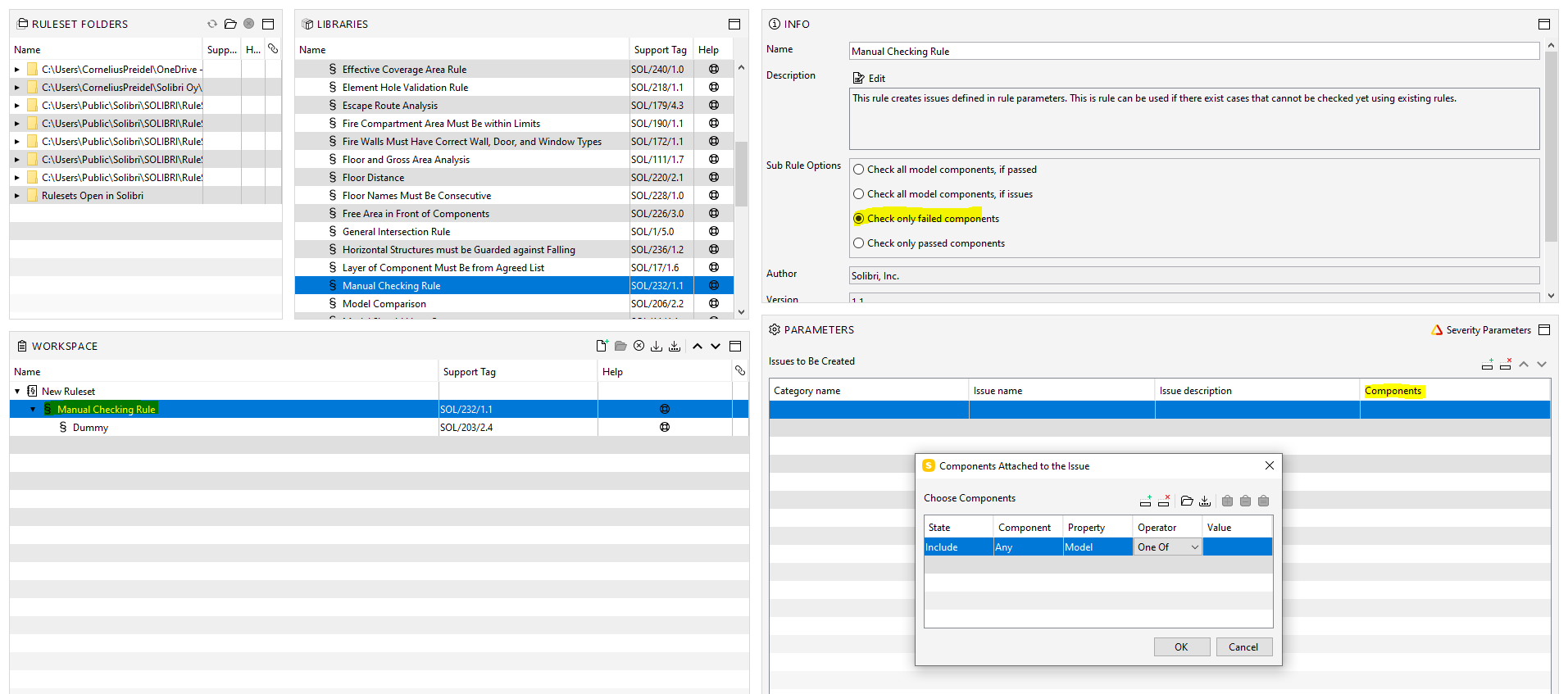

    Is it possible to make a Ruleset with a gatekeeper so you can check only 1 model and see only the results of that model? I’m trying my best but I won’t succeed…

      if I understand correctly you could use Rule #232 (Manual Checking Rule) to “presort” those components which belong to a specific model by creating issues for those. The manual checking rule creates issues for all components which fulfill the component filter (see screenshot). If you configure the filter to create issues for any component which belongs to a specific model and specify the gatekeeper, that any component with an issue is taken forward by the subrules, this might do what you want to achieve?!
