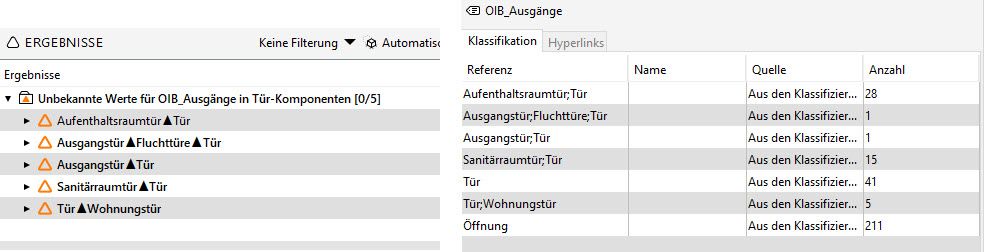

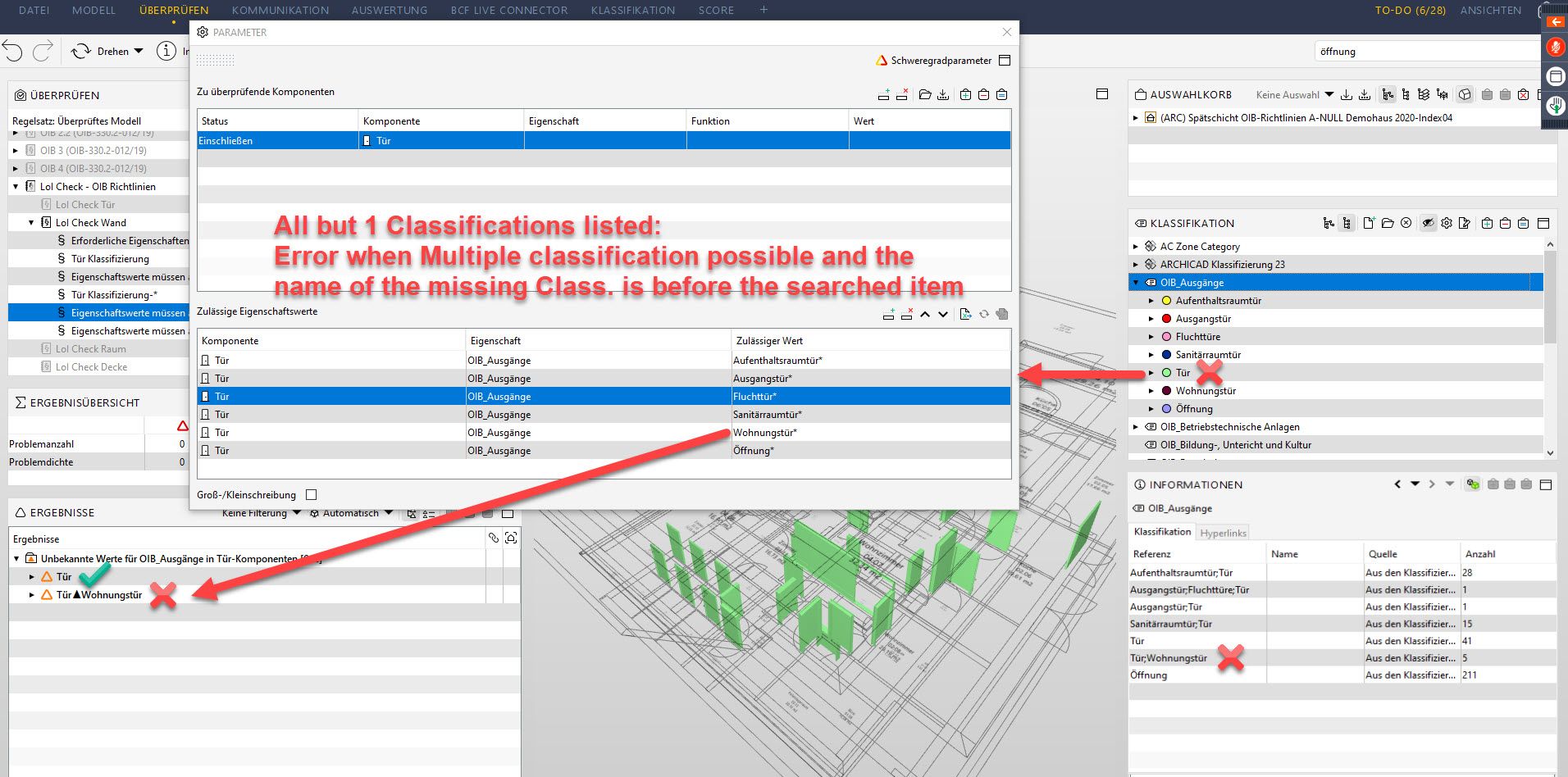

      I believe I have found the answer when I tried to find a solution workaround wit SOL9:
      Error occurs when Multiple classification are possible and the name of the missing (or not searched) Class. is before the searched item.
      Here is how Solibri classifies these:
      The solution would be to type the searced classification with Wildcards, and they have to be before and after the searced item. Otherwise, you will only get the results where the non-searched item is after the searched one.
      Hope it serves you well.

        And this problem occurs whenever multiple classifications are checked in almost any Rule.
          @marchi said in Required Classification Check (SOL 11) not working, giving wrong results, when multiple classifications are allowed?:
