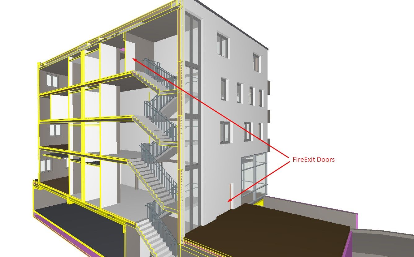

    I was experimenting on the Escape rout in the checking rules. I was adapting our new office standard, when I stumbled upon some unfamiliar topics.
    I have a three storey building. On the ground floor and 3rd floor I have defined a door with FireExit option (one is external and the other internal). See picture below:
    The checking concluded that the escape route from the 1st floor exceeds the length, hence reporting and error. So if the 1st floor is not OK, why is the second floor not included in the results? It does not have any other doors on the way, except the one on the ground floor.
    I assume that the path is going upstairs to the 3rd floor where a FireExit door is located. This is off course wrong.
    I did not find any option to define the escape route only downwards…
    Any tip what I might be doing wrong?

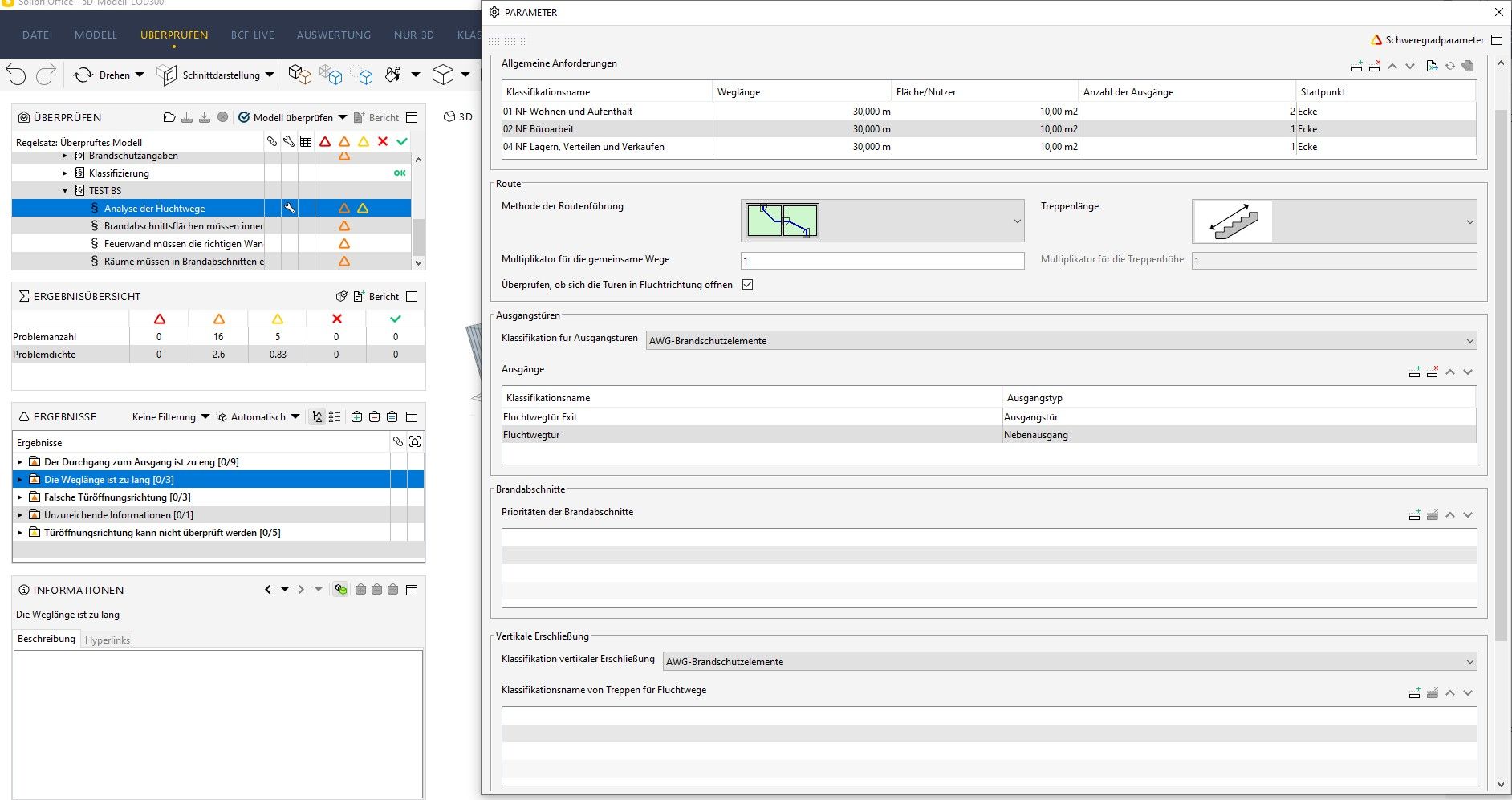

    Here are also the settings for the checking:
    Any advice?

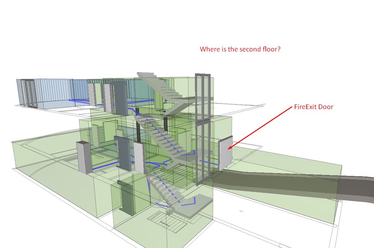

        At the moment the rule would seem to calculates the shortest path between the door (or internal corner) of the space and the nearest fire exit door, so in your example the second floor is ok. Try to open the rule tools and see the calculation of the exit route of the second floor :
        Perhaps the solution for your model would be to indicate only the external fire exit .
