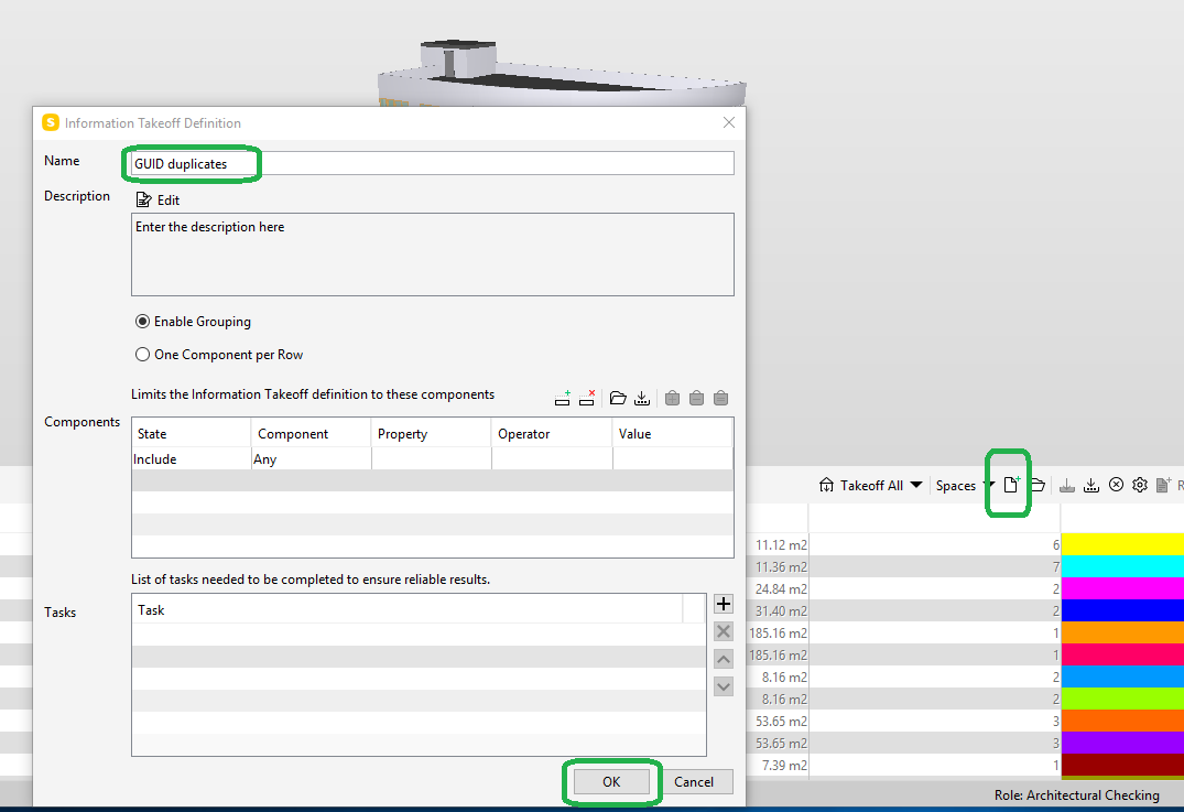

        • N Offline
          N Offline
          Nuno
          You can create a new ITO:
          Edit the the first column:
          Choose Indentification > GUID :
          Remove column “Type”:

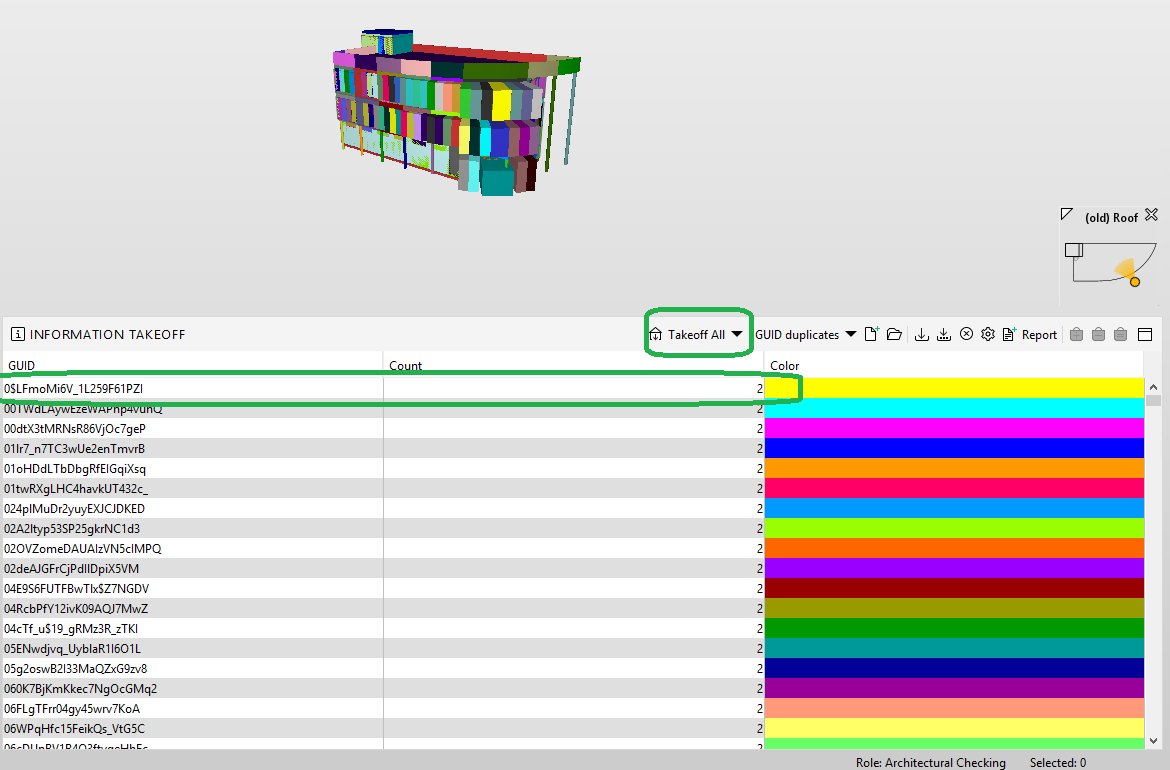

          Run the ITO:
          Duplicates will have a count number bigger than 1. This example has two times the same model.
