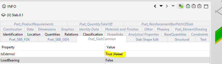

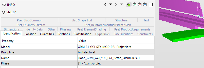

    I have questions about the form/style of some Pset titles and parameters value in Solibri. I am trying to understand why are there some Pset in italic written and some not (same for parameters sometimes in italic ? Why sometimes parameters values are written like this
    Here are some examples:
    Here is one slab selected and all Pset titles are normally written:
    Here is one other slab selected, and some Pset titles are normal and others are in italic:
    Last question: Do you why or what causes this kind of value ? Could it be causes by an Ifc export mapping parameter mapping table ?

      replied to Maxime Sabbagh on last edited by
      @maxime-sabbagh
      https://society.solibri.com/topic/683/italic-font-for-solibri-properties-values?_=1619695830473
