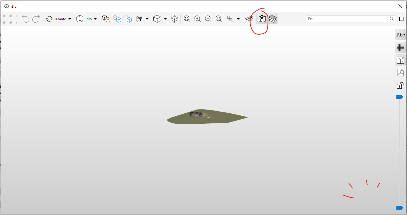

    So, the navigation map seems to have disappeared in some SMC models (it works fine in others). The “Show Navigation map” button does seemingly nothing. The list of levels on the left side of zoom buttons is also empty. Is it bugging out or is there a way to get the map back?

      replied to Ville Reima on last edited by
      @ville-reima said in No Navigation Map:
      Is this happening with all your models?
      Which Solibri version you are using?
      You could try to remove following node in Windows Registry Editor:
      Computer\HKEY_CURRENT_USER\SOFTWARE\JavaSoft\Prefs\com\solibri\saf\plugins\java3dplugin\ui
      It stores the size of the map.
