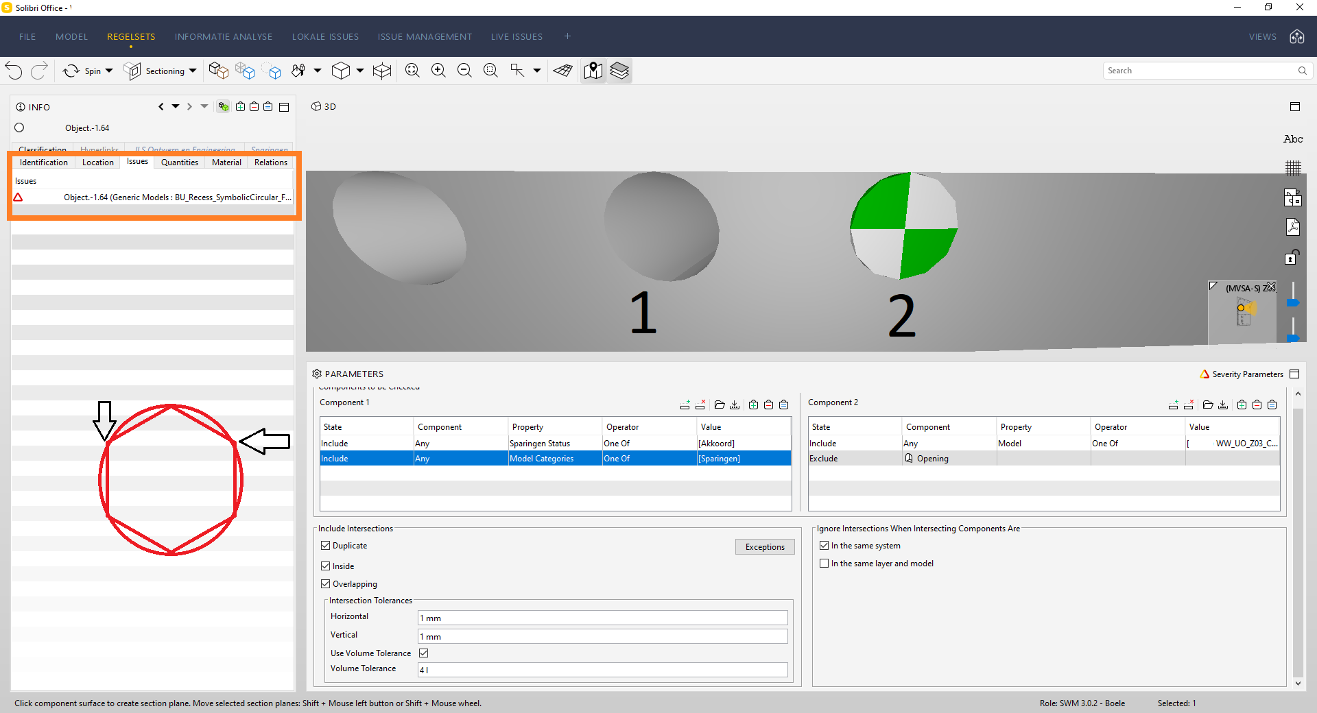

    I want to check if the installation recesses are copied or modeled in the structural model.
    The recess is exported as Triangulated and the opening in the structural model is exported as a circel opening.
    This will give a clash, but should not be a clash.
    However I cannot exclude this properly via Tolerance.
    Anyone can help me with this?

      Hi, I don’t know if it’s useful 4 years later but you can change the unit precision in the unit setting and lower the volume tolerance. 🙂
