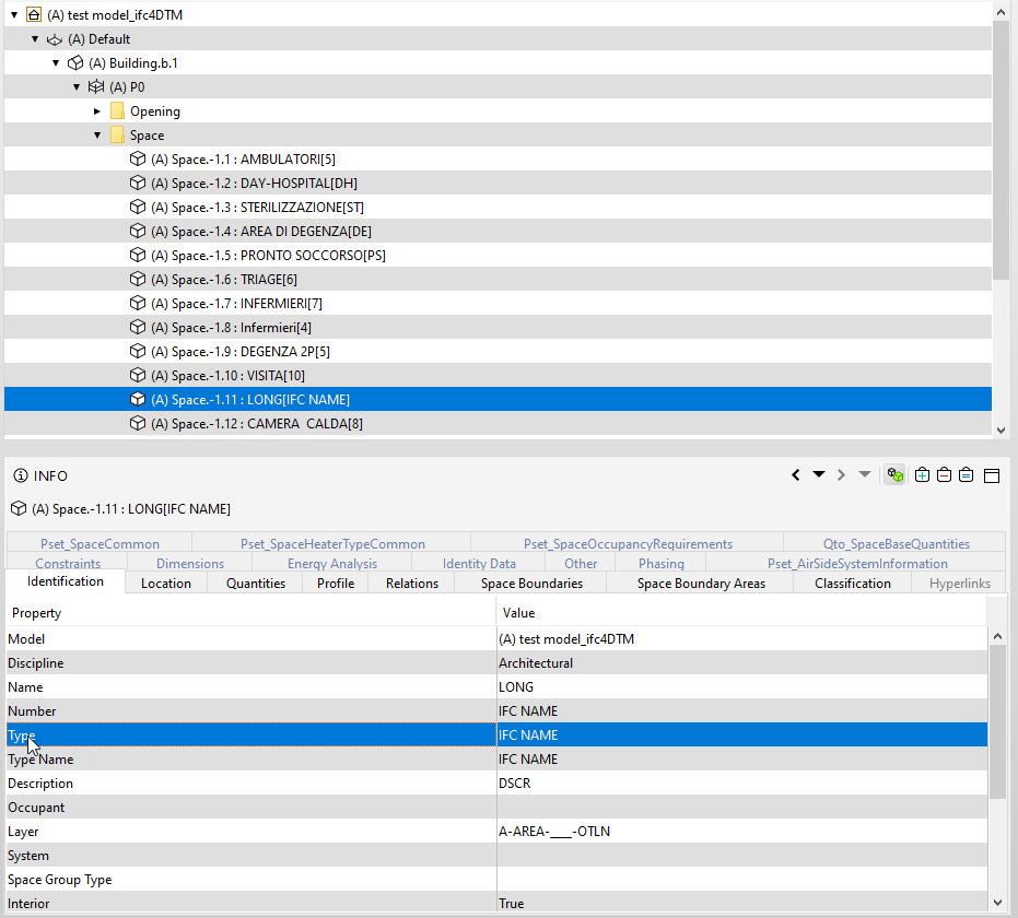

    Hello everyone,
    any Revit users who know how to set the Space Type attribute in Solibri? By default is concatenateing the room name + room number. I would like to use a new parameter.
    I tried to use IfcSharedParameter IfcExportType, IfcType, IfcObjectType but did not work, both Ifc2x3 and 4!
    If I use IfcName it does override the number, IfcLongName ovverides the name, 2021-06-15 19_08_42-Window.png
    It would be really helpful while using the rule 175 to check if the space group contains a list of generic spaces (not depending on names or number)
    Cheers
