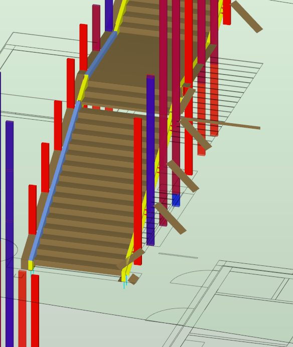

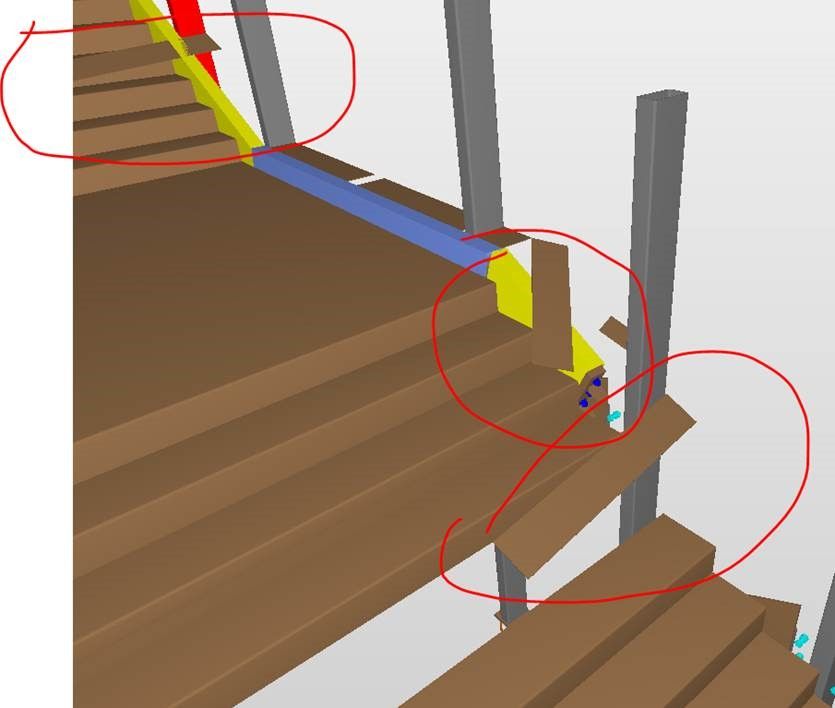

    We are having graphical issues with Solibri reading IFC steel fabrication models generated from Bentley Prosteel.
    See attached screen shots.
    This IFC read fine in version 9.9 but not 9.12.
    Can someone please help as we need to use 9.12 for the reviews to create issues in anywhere, which they can’t do in 9.9.

      @stephencorn
      Thanks for report. The same problem was reported also to the Solibri support.
      The fix for this problem is included in the next release version.
