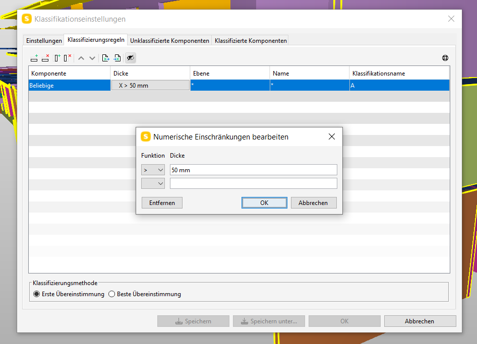

      @mjkayali
      You are talking about wildcards, your title is imho a bit missleading.
      Anyhow, if the data type allows numeric restrictions then you can work e.g. with operators.
      Still, you are right it would be good to have a documentation or a cheatsheet where you can look *. ?, ???, … up.

        @JSN
        Thank you for showing this example, you’r right I have changed the title little bit and the question as well.
        I ment also the coding, it would be nice if you can go further than only (*) and (?) like using (!=) for not equal or searching a non case sensetive string…
        *Maybe adding scripting column considering the left column an input and the right one an output can be an idea for future versions of Solibri. but that a bit too far i guess.
        for now a cheat sheet with some examples would be good enough.
