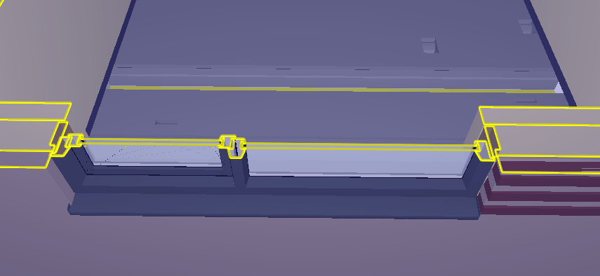

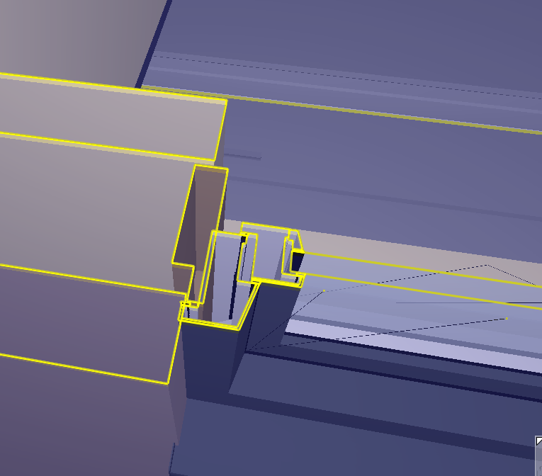

    Dear Solibri Specialists,
    I have a question about how to detect this clashes.

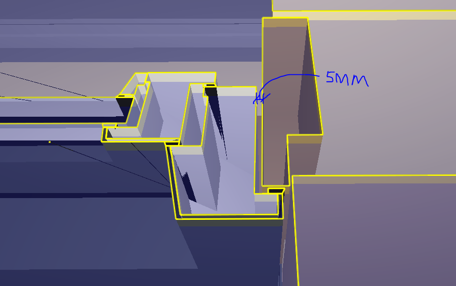

    I have to check if the horizontal distance between the inside of the wooden window got 5mm distance to ouside of white window.
    This Problems have to be detect
    Could anyone help me?

      maybe you can try SOL/222/4.2
      i think “Shortest Distance Between Shapes” will do the trick for you.

        RickLandkroon
        If i check this I get the results of the 2mm fault, i would like to get the 5mm fault.

          MauriGalan
          replied to RickLandkroon on last edited by
          @ricklandkroon you just need to change the distance to the ones you want. Which rule you are using ?
