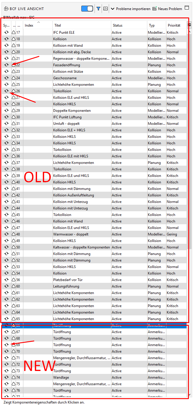

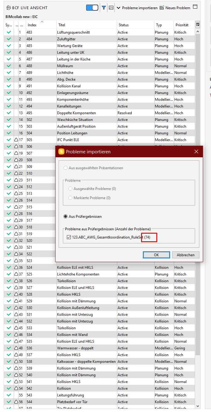

    For some time now, I have been using the BCF LIVE Connection and one thing that has been bothering me is the updating of Issues from results. After each check, I get the same number of results, since probably Solibri is counting the actual amount of issues.
    The Connection does not work synchronously between Solibri and the Live View, meaning it does not check what is there already in the Live View. Therefore, every time I might add some issues to a result, I always get the total number, which then ends up in the live view ready for synchronization. In my scenario from the 74 Issues, only 15 are new!
    I simply then delete the ones that are already in the BIMcollab platform and leave only the new ones. But that is not quite the workflow that I would prefer.
