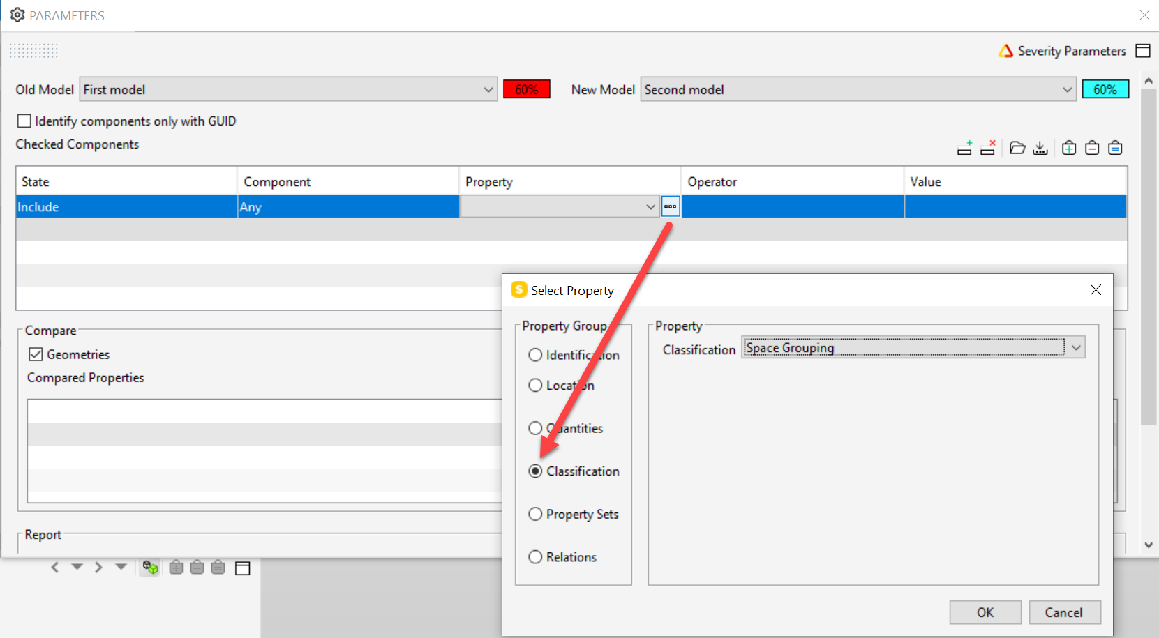

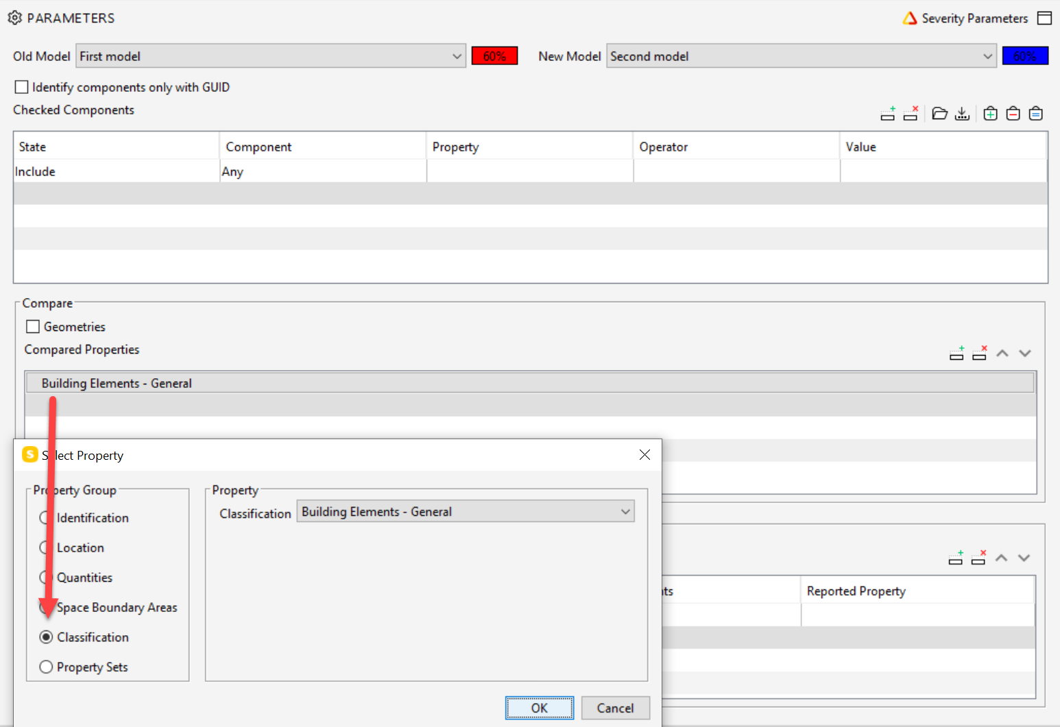

      hello @jack-allason ,
      Yes. you can check for changes in a Solibri classification or property sets with the model comparison rule (SOL/206):

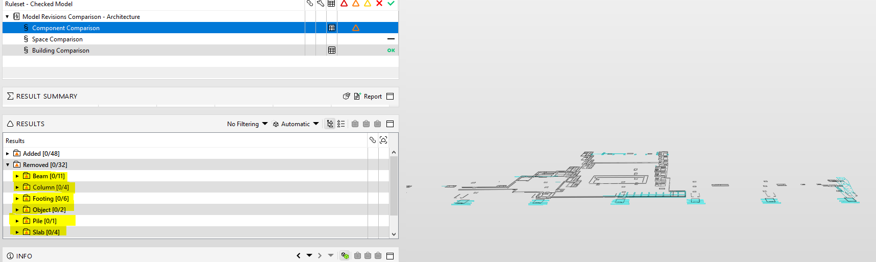

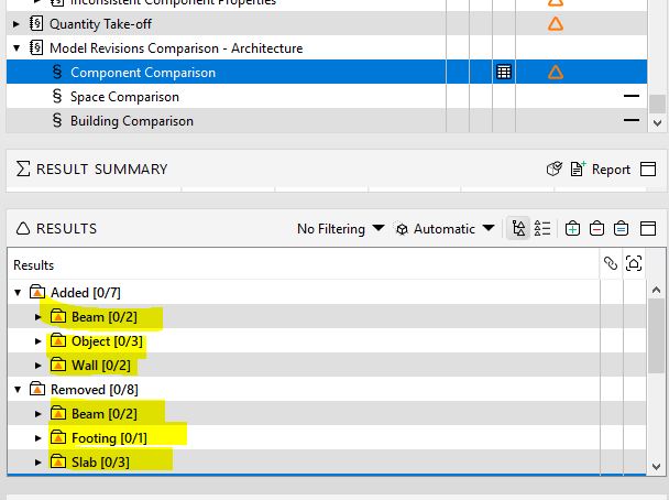

        Thanks. What I actually meant was, can the items that are listed at the sides (added/removed/modified) be based on the classification I have set?1997fa2e-3c04-4b39-8a7b-f17811601a44-image.png

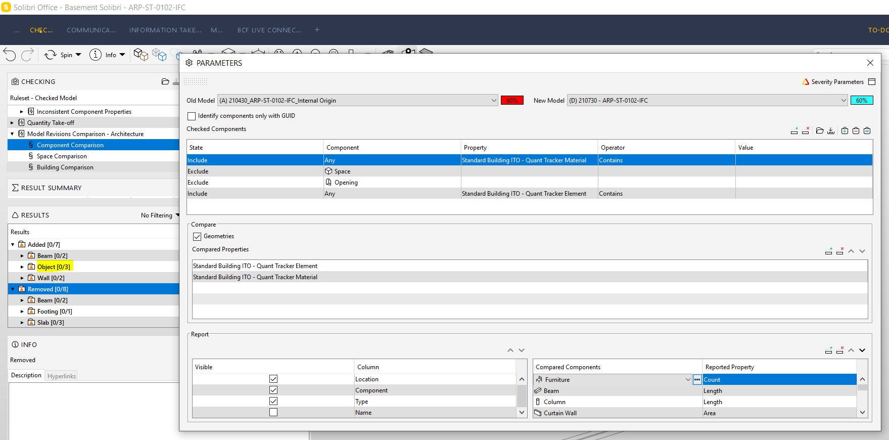

          @Jack-Allason yes, I think it is possible.
          Just add the classification in the main filter of the rule and it will check only those components:

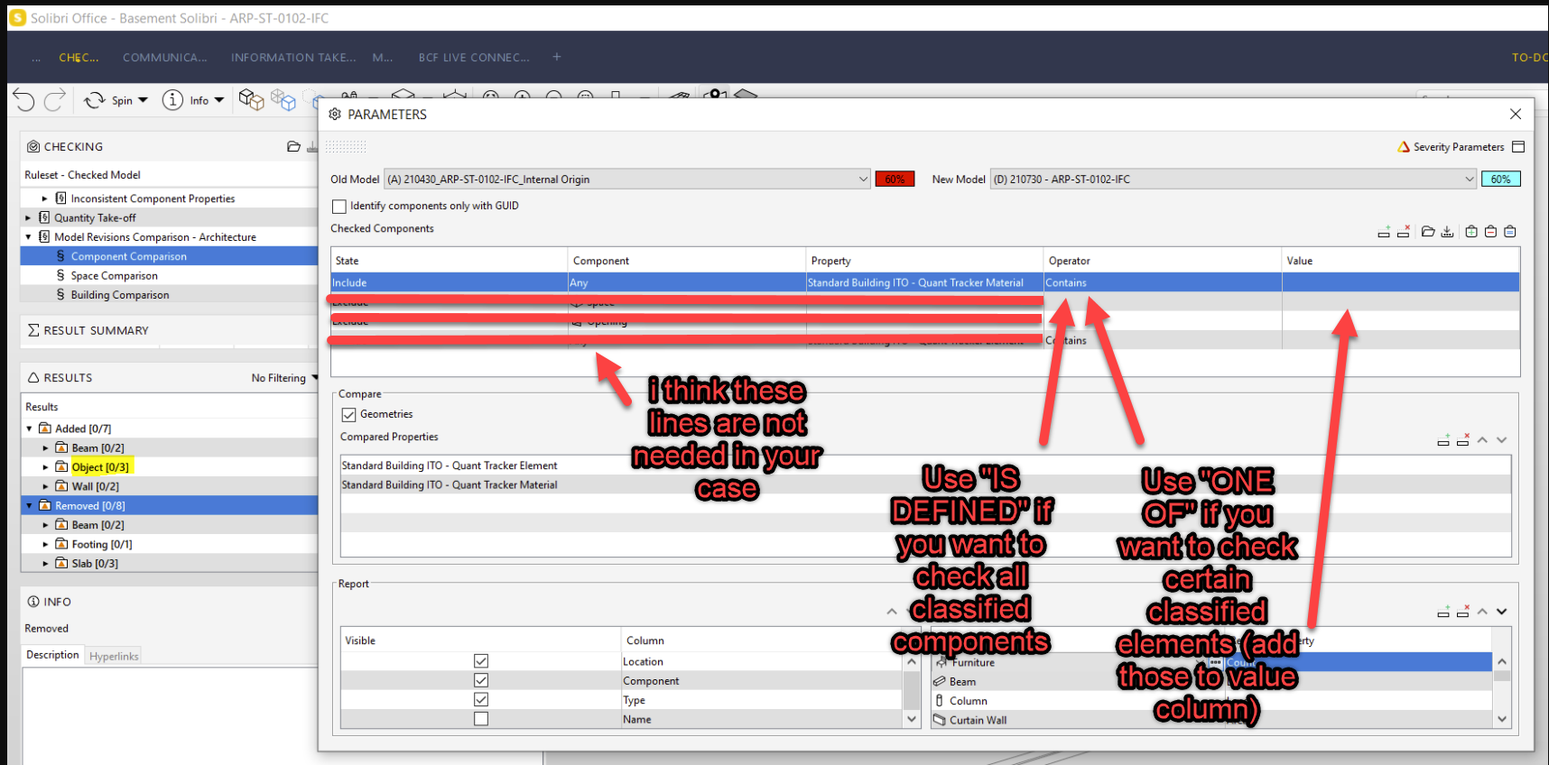

            Thanks for that. It still doesn’t seem to be working though. My classification doesn’t specify “objects” and I can see that this is still being displayed as a result. What am I doing wrong? Or is this just not possible?44d1b0e3-813a-4af7-a643-d48ce5044906-image.png

              @jack-allason,
              If i have understood correctly, you should be able to check only the components you have classified by setting the filter of the rule like this:

                Hi Lauri,
                I can get Solibri to check the items I’ve classified, but the way it “sorts” them is the issue for me. Say for instance I have use a classification that classifies all my items by uniclass codes and I want to show someone a comparison between uniclass codes, I cant do it because the items on the left are sorted by “Beam, Column, Footing, Object” etc… and not Uniclass codes. - I wonder if there’s a way to make this possible in future? Would save me a lot of time.
