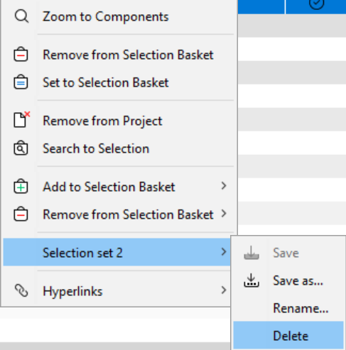

    How can i delete saved SelectionSets from the SelectionBasket?
    To be specific. How can i delete the selectionSETS them self.
    Im not looking to empty the SelectionBasket.
    Any help appreciated! 🙂

      Hi @bim-lord ,
      It is a bit hidden, but by right clicking in the selection basket view it gives you the option to delete the currently active selection set:

        @lauri-luoma Thank you!! Can i set this as an accepted soution or anything?
