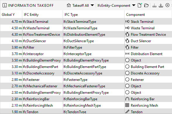

    is a table where it is shown which Component name belongs witch IFC Entity or IFC Type?
    For example i do not find the Component name for IfcInterceptor

      Hi @89jaka
      I created an IFC with all the various IFC Classes along with an ITO that reports the Ifc Entity, Ifc Type and Component in Solibri.
      It is attached: Ifc4_Classes.zip
      Note that the predefined type also determines the component in Solibri. For example, for a slab:
