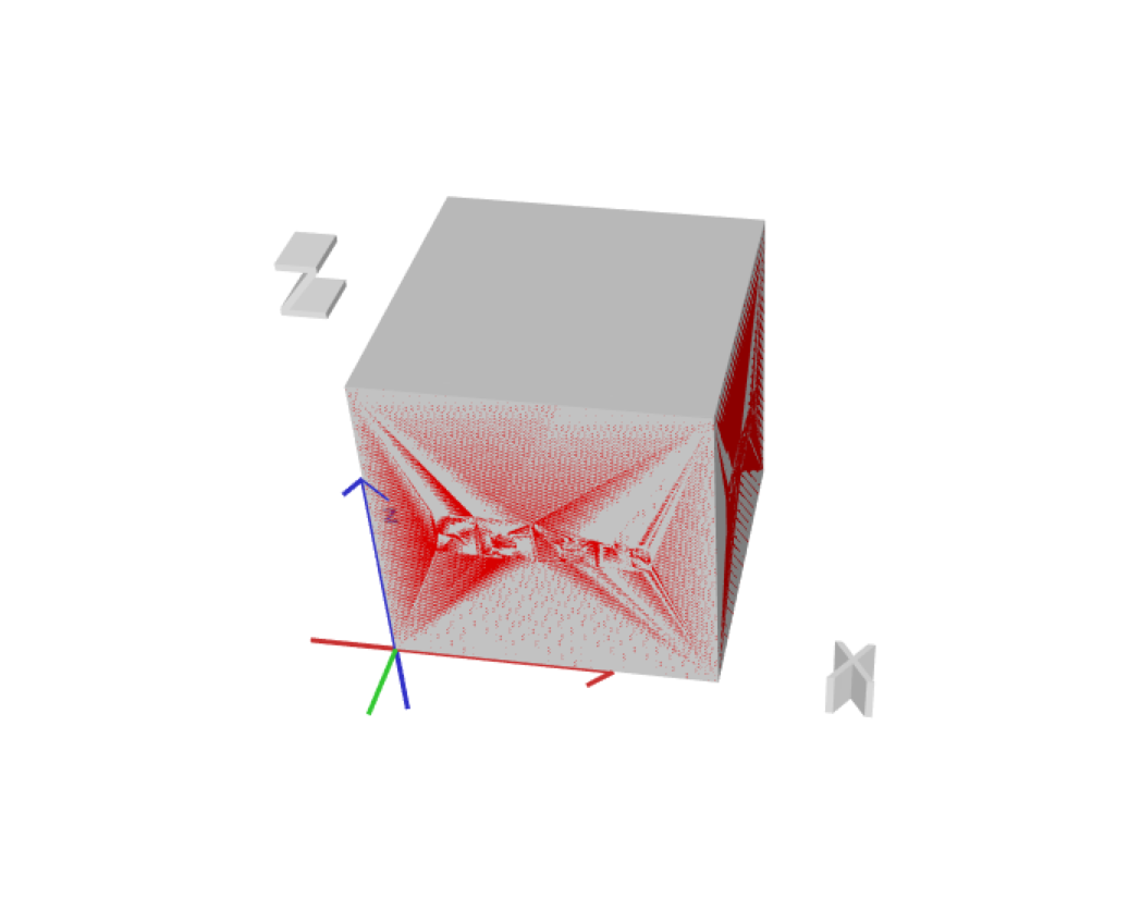

      Maybe not the answer you want, but we don’t use checking rules for this. Visual checking is faster for us, because we require other parties to export a cube of 1x1x1 meter on the coordination point in their model(s). A difference in the position of a cube will allow the user to see quite fast which model is off and easily measure by how much.
