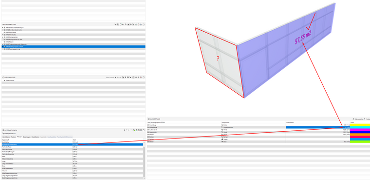

    I am having a bit of a problem with extracting the area from a curtain wall.
    It is modeled as one piece in Archicad and exported as an IfcCurtainWall as an IFC2x3. In Solibri it shows the area of only one side, but not the other?
    The parameter that I chose is gross area.
    Any idea of what is happening here?

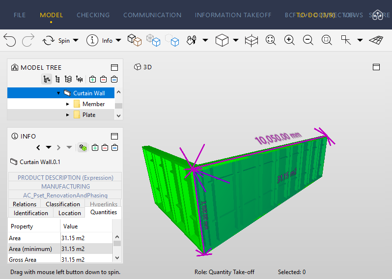

      I was able to reproduce this issue with the file cw.smc of a curtain wall I drew using the chained poly-line, which results in an L-Shaped single curtain wall.
      Solibri is only calculating the length and area of the longer side of the L-Shaped wall.
      I’ve sent this to our development for investigation. Would you be able to split the curtain wall into two separate lengths so that 2 curtain walls will exist with their individual lengths/area?
