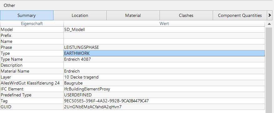

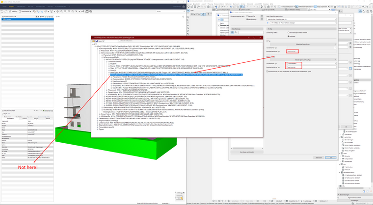

    I am exporting an element as an IfcBuildingElementProxy with a USERDEFINED: EARTHWORK Type from Archicad.
    The Type is defined in the IFC Schema, but not appearing in Solibri. I just see the entity definition but not the USERDEFINED and especially with Type exactly.
    A bug?
    Why other entities can show predefined types and not the IfcBuildingElementProxy?
    In BIMcollab Zoom it is there:

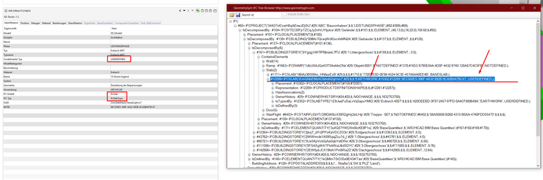

      I have also tried with IfcSlab and a USERDEFINED. It looks a bit better, since I am able to see the USERDEFINED, but not the name of it.
      Do I have a bad feeling that Solibri is not getting correctly the IFC Schema in the USERDEFINED level?
