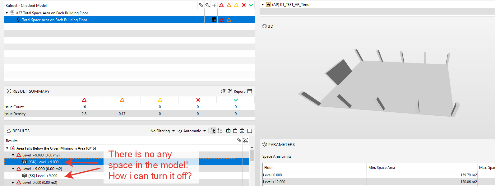

    I have a question about check #37 Total Space Area on Each Building Floor
    After checking i have an issues in models, which have no any space element inside!
    How i can filter model without any space on floors? Thank you.
      E.g. #230 as Gatekeeper?

          Hi @zeraxel
          I logged this issue with R&D for a request to filter the models in this rule such that only those with spaces should be checked.
          I believe this rule was to be used with a single architectural model loaded rather than a federated model. As @JSN suggested, you can workaround these extra results that come from other disciplines through a gatekeeper.
