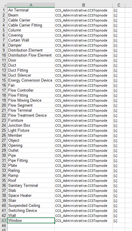

    I need a full list of Solibri Component Types like the one in the image here, column A.
    -but like, full, all Component Types.
    Does anyone here have a list they’d like to share with me?
