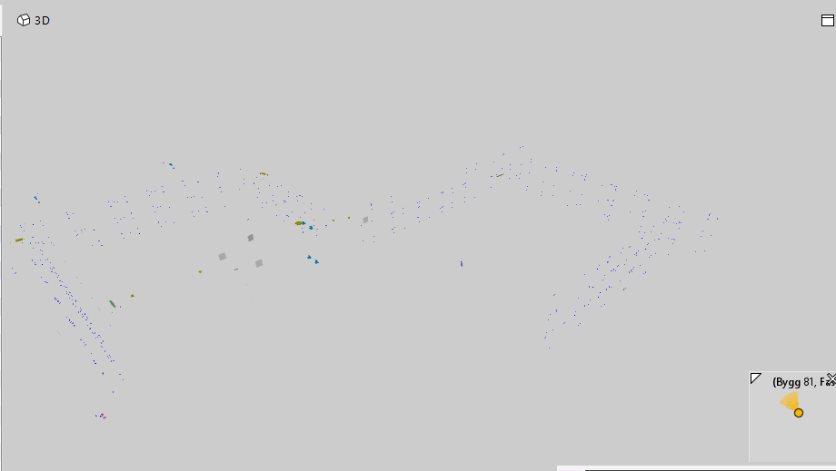

    Trying to save some issues that only shows a list of specific components. Have tested on several PCs and it seems to be working for me, but I get feedback that for others it shows all objects. It needs to work for everyone both internally and externally.
    The issue is saved after putting objects to selection basket and objects are added to the issue itself.
    Any tips or best practices in order to to make sure this works for everyone?
    It should look similar to the attached picture.

      Is everybody in this situation using Solibri, or are we talking about different software here?

        Yes, everyone is using Solibri, but I think we found the problem. Seems to be a difference somehow if the BCF file is saved with 2.0 or 2.1. So for 2.1 it shows all objects, but when saving with 2.0 it isolates the objects as intended. Does not make to much sense for me, but at least it works with 2.0 🙂
