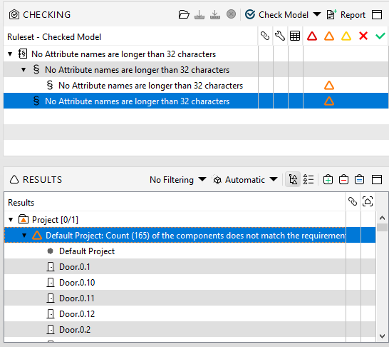

      Interesting question. Unfortunately, out-of-the-box there isn’t a very elegant way to check the number of characters a property name has. It is easy to do for a property value, but for the name of a property, you’ll have to search for the violating property sets of a components that are returned.

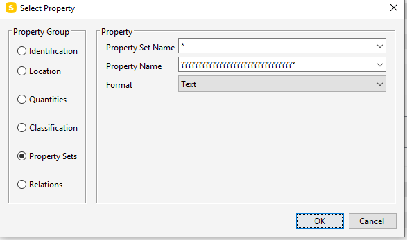

      You can use wildcard characters ? and * in the component filters for the property set name and property name:
      So for example, this will match any component that has any property set (using the * for the property set name) that has a property name that has 33 characters or more (using ???*)
      You can use the Property Rule Template with Component Filters in this manner as a gatekeeper rule and pass the components that pass to a Manual Checking Rule to then look over the properties of the returned failed components. Unfortunately, it doesn’t state what property matched ???*.

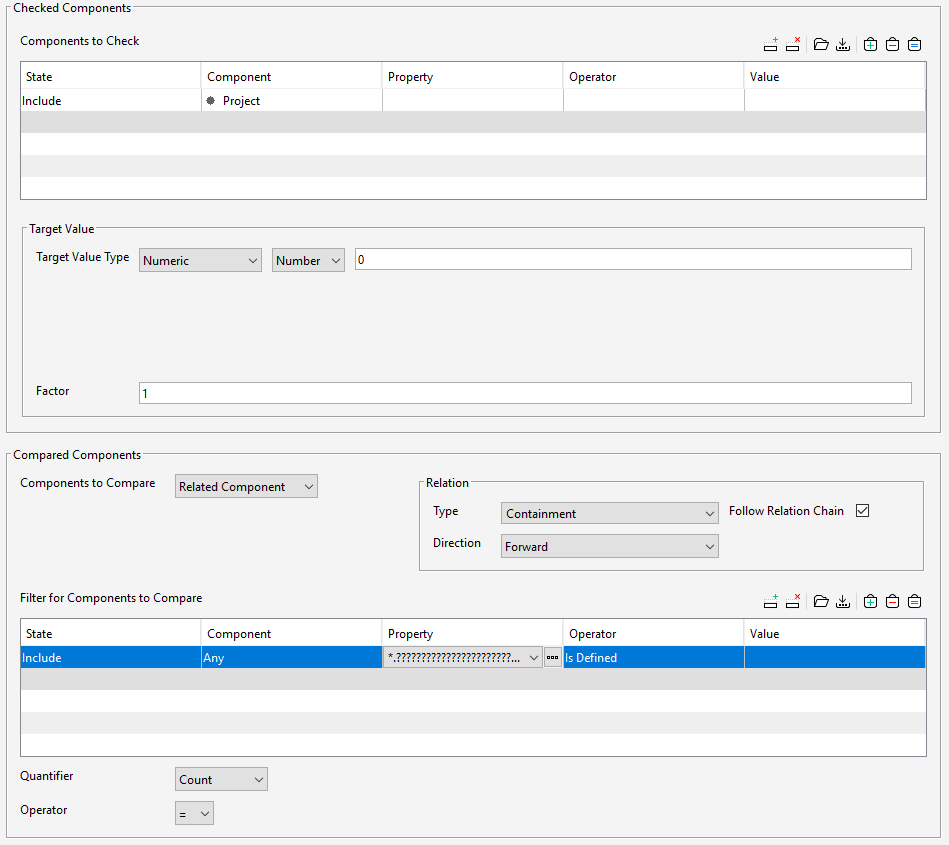

      Alternatively, you could use Comparison Between Property Values to check that no components are contained in the project:

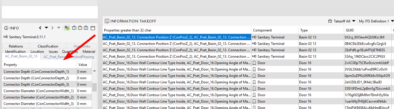

      I created a simpler example of using the API to return the properties that have names that are greater than 32 characters in a Javascripted ITO:
      It lists in a comma separated list any property names along with their Pset they reside in that are 33 or greater chars.
      Hopefully you can find this of some use. It is included in the example .smc here:Solibri Building_MAX_32_Char.smc

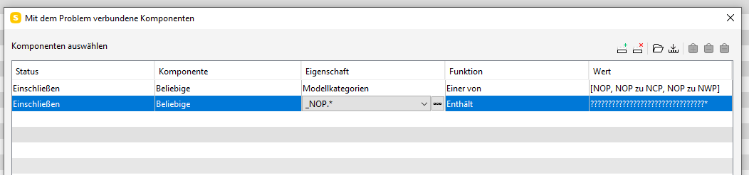

        However you brought me to a new idea of how to use the Manual Checking Rule :
        I include all of my own models according to their category, and search the company PSet for Attribute values with more than 32 characters.
