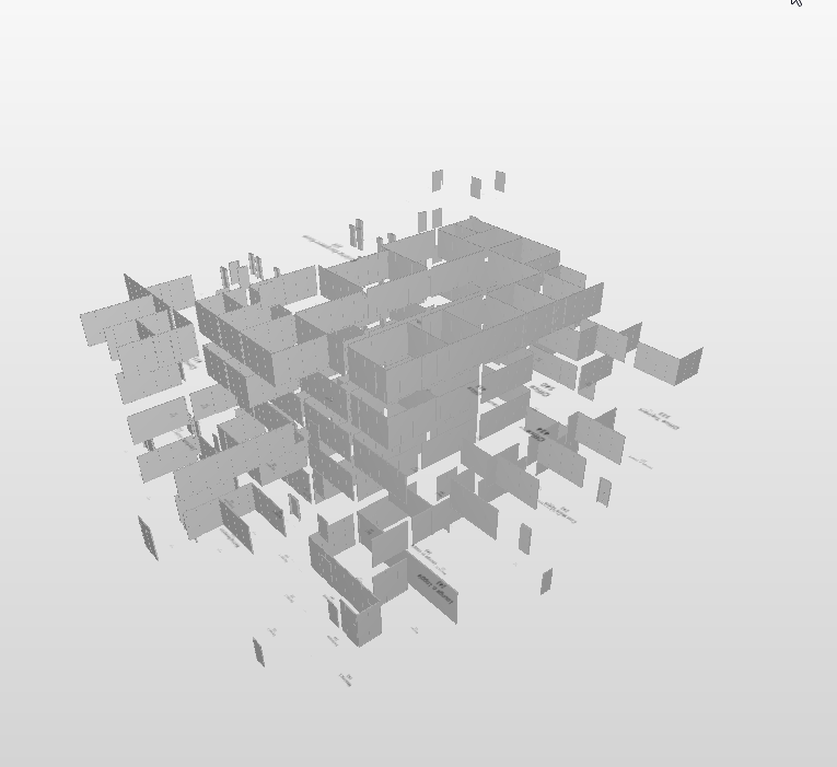

    I have a group of elements like in the attached screenshot, is there a way to add them to a classification?
    2021-10-18 09_11_34-Solibri Office - 211015 - ARC_Teilmodell Commercial-vom Teams.png

      You could create an ITO for the relevant elements and assign it there if you make the classification column editable.

        Thank you @jsn
        It is a very nice way around to get it done 👍
