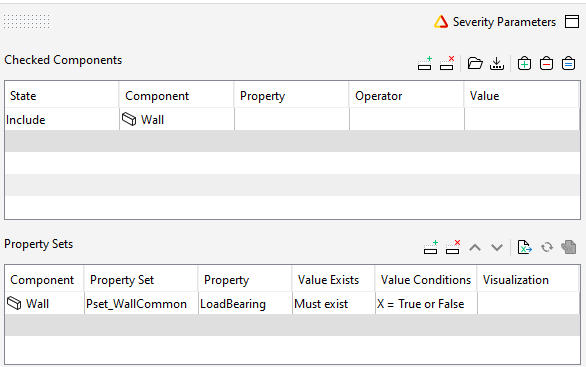

      Hi @didierz
      You should be able to use the Result Summary view to report the counts of components that pass/fail your rule.
      First set up the rule as below: 7fec7ac6-e592-493b-b9a4-63ca61ce6dcd-image.png
      Select whatever rule(s) you wish to report in the Result Summary View, and click Report:
      The excel report will include counts of the components that pass/fail: 5b3ff750-73a6-4f52-b87a-9cc344c7803f-image.png
      More info on the Result Summary view is here:
      https://help.solibri.com/hc/en-us/articles/1500004671222-Creating-Reports-from-Checking-Results
