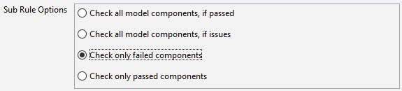

      @gju Hi! Do you try rule gatekeeper?
      Check out great explanation about rule gatekeeper in Solibri: https://help.solibri.com/hc/en-us/articles/4409667867799-Part-5-Rule-Refinement-2-My-Second-Ruleset
      So, you can use other rules to check only components that passed check or not passed.
