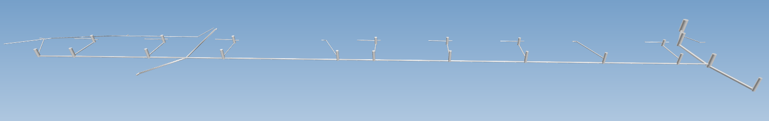

    I have made ifc model export from AutoCAD using XBIM. Model in Solibri is shaggy ,but in BIMcollab in fine. Does anyone have any ideas that I need to change in ifc for the result to be good for Solibri? I’m pretty sure the reason is the large coordinates in the AutoCAD drawing, but result ifc has to be in the same coordinates.

    Picture of model in Solibri
    Picture of model in BIMcollab Zoom

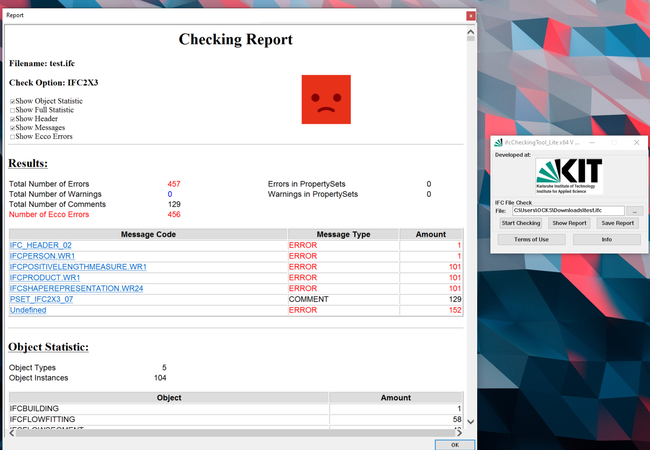

        I trying to check your model with ifcCheckingTool_Lite_x64 (for some issues of ifc structure), so it has many problems with geometry representation.
        So i think it is not problem of Solibri, but problem of XBIM exporter. Check it yourself.
