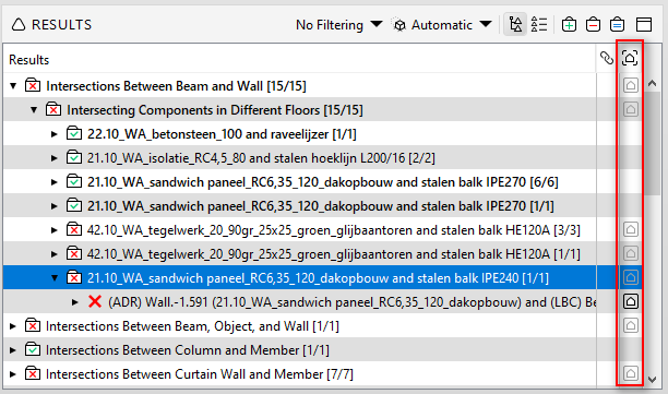

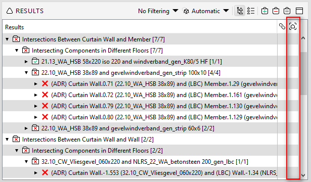

            When I update te model, after it is already checked, the clashes (not all clashes!) lose their link with the issue in the presentation (communication tab). It loses the link shown in the pictures below.
            The problem is, the clash still stays rejected. The issue still exists in the presentation, but it doesn’t contain any components anymore, like in the picture below.
            These are just examples.
            It doesn’t happen with every model and it doesn’t happen with all the clashes. It also happens to all kinds of elements (in this example curtain walls, but also to walls, beams, etc.)
