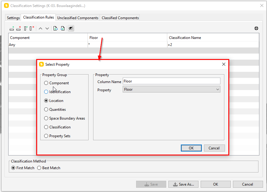

          I allways use a classification to check level name and if elements are attached to the right level.
          Try this.

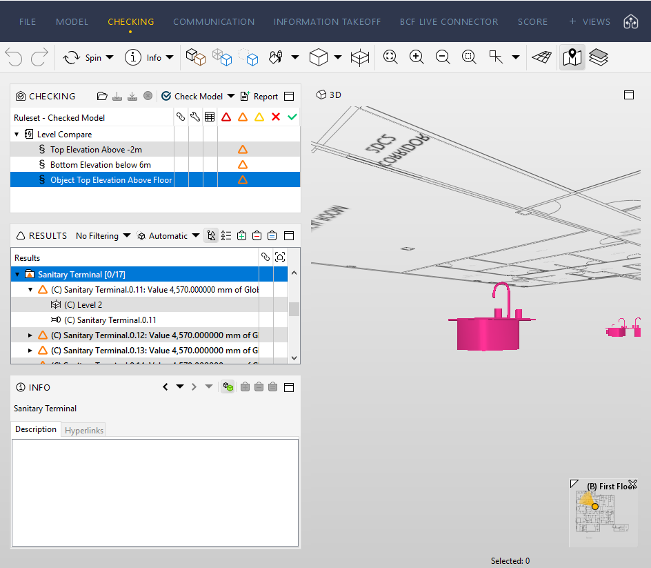

            • john.lippJ Offline
              john.lippJ Offline
              john.lipp
              replied to plauze on last edited by john.lipp
              Hi @plauze
              Here is a ruleset that uses the comparison between property values rule to check for objects with top elevations lower than the elevations of the floors they reside on:
              Level Compare.cset
              You can see it finds some sinks on the wrong level:
              You’ll get false positives of components that are suppose to be below the elevation such as footings and maybe sunken slabs.
