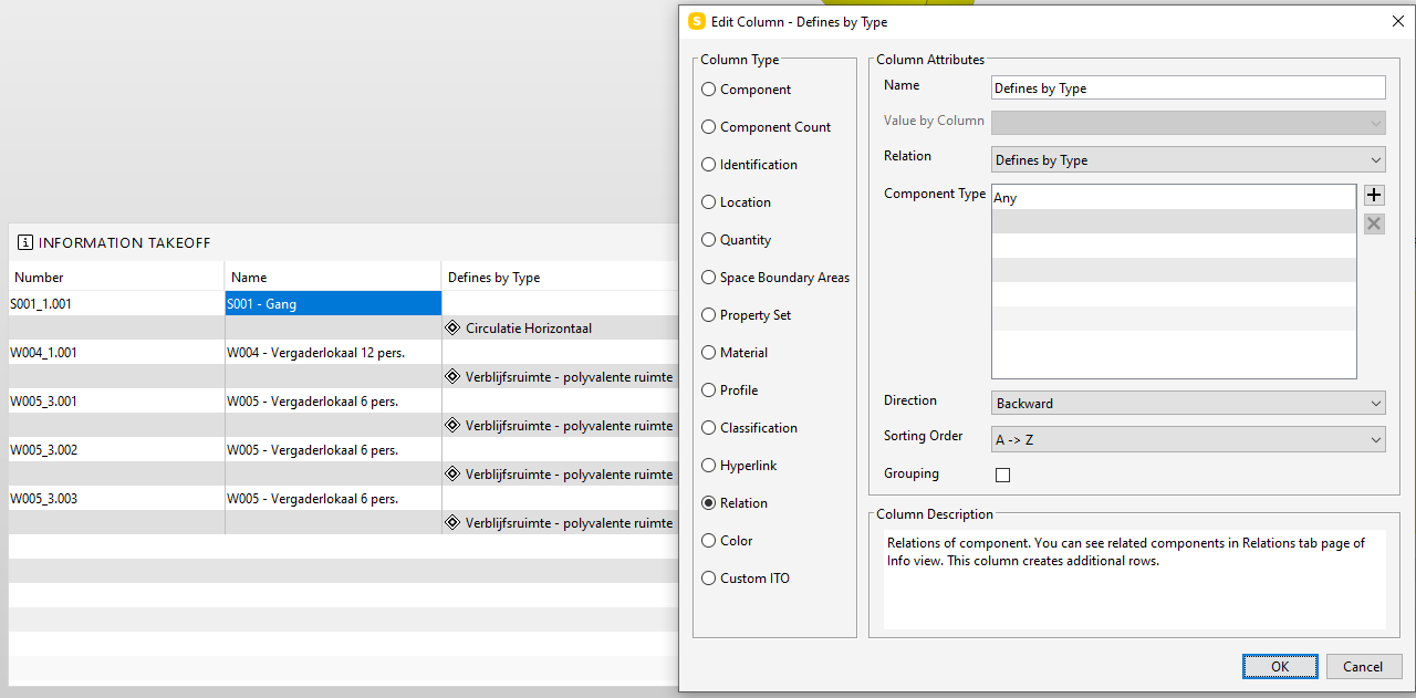

    I have a SpaceType with a Description. The Description is only visible in Relations > defined by type > Description. How can i make a QTO of this Description?
      SJV-Wil
      You can add a column ‘Defines by Type’ in the ITO:
      The direction is Backward when you see this symbol in the relations tab:

        @sjv-wil Thx. That is the way i wanted 🙂
