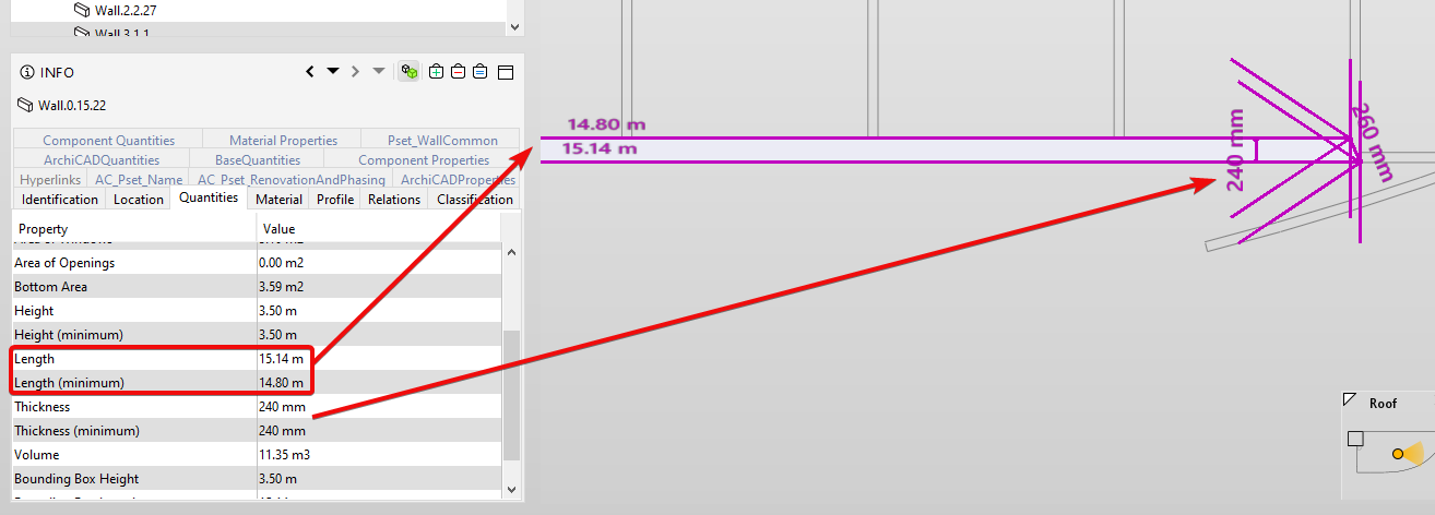

      @anees-alomar
      You can use the dimension tool to take point to point measurements.
      If you need to report the lengths in ITO or check them in a rule, you are limited to the Length, Length (Minimum), Thickness, Thickness (Minimum), Height, Height (Minimum) under the Quantities for walls.
      You may have a native Dimension property sets.
      For miter joins it can be tricky since the inside face length can be shorter than the outside, but perhaps you can use the Length (Minimum) for inside and Length for outside:
