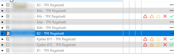

How are you guys structuring clash detections in large projects?
I have made duplicate rule sets and use them on each building.
This way I get a presentation for each building.
If I have to change some rules, it’s a little annoying to do this in every rule set.
I also sometimes get duplicate issues bc of models which belongs to several buildings.Anyone has success on using a single rulset and checking little by little here and there by following the project process?
Filtering the results based on building parts is also quite useful but in the end I desperately miss the feature to e.g. filter created slides by issue position /better a specific classification - or e.g. alternatively to create presentations from checking results only based on such a filtering. If anyone has a proper workflow suggestion which does not need duplicates of rules or lots of manual labeling I would be more than happy.
