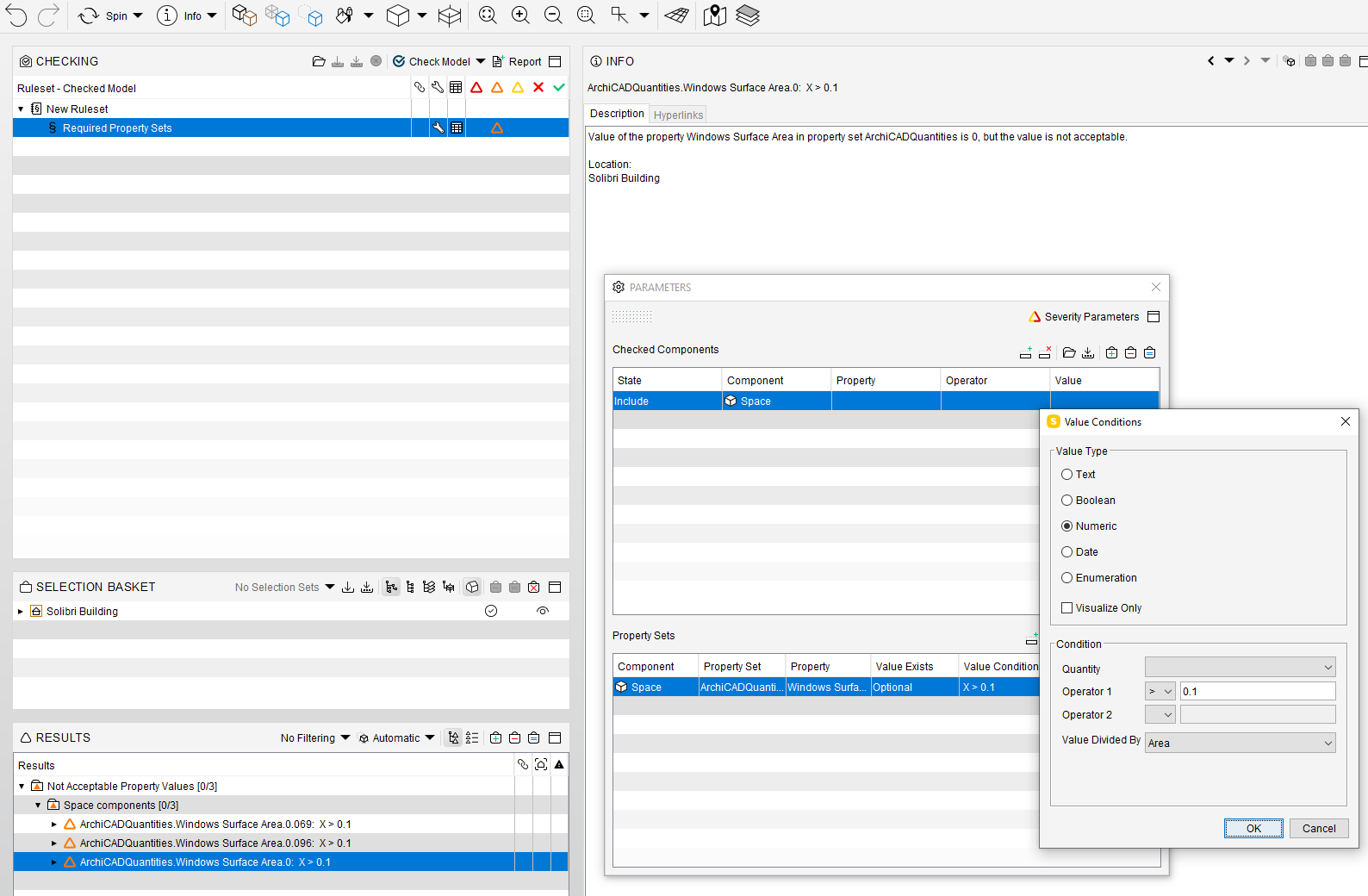

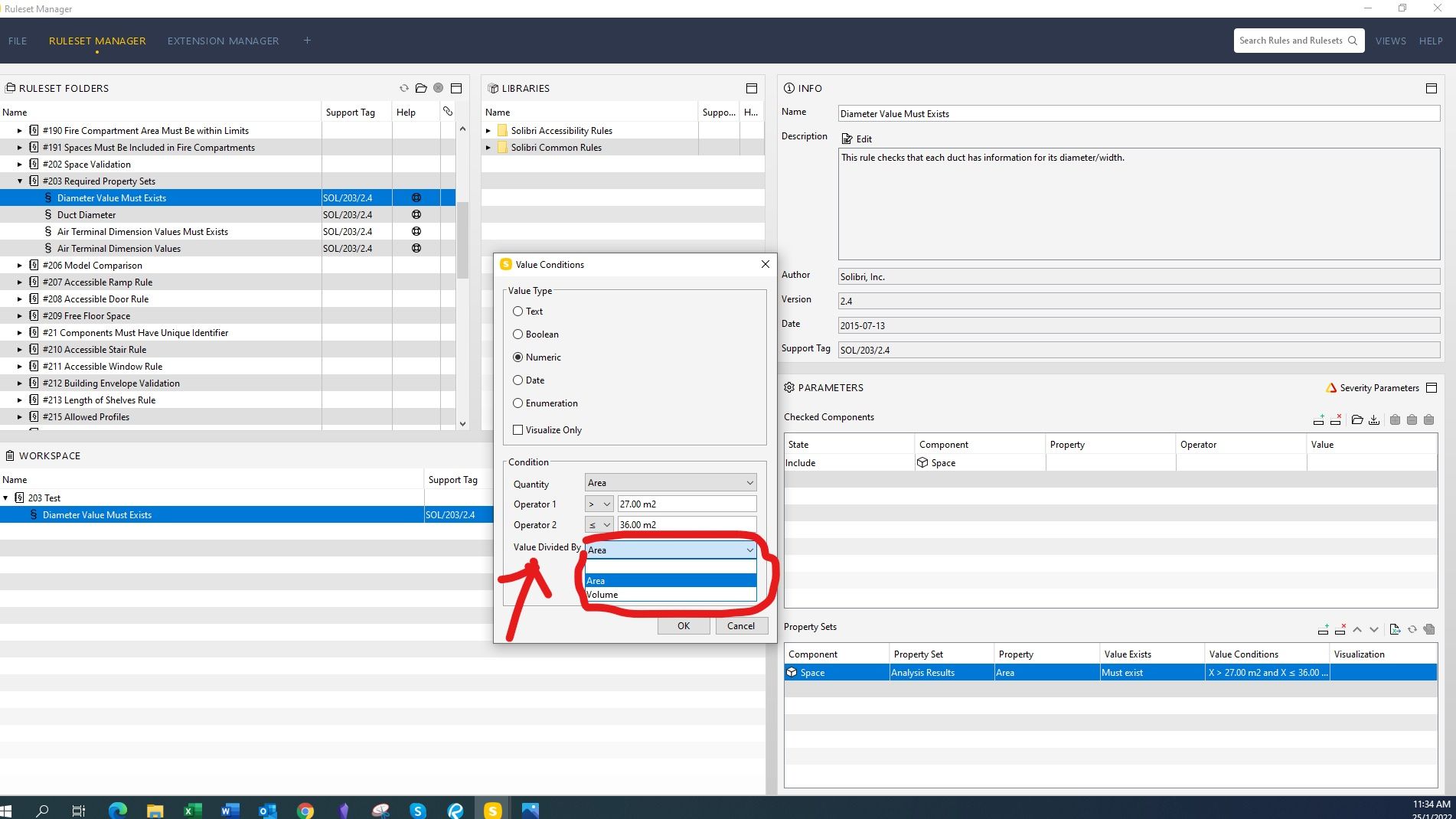

    Can anyone tell what “value divided by” means?
      https://help.solibri.com/hc/en-us/articles/1500004738242-203-Required-Property-Sets
      “For numeric properties, you can set the unit and limit values. You can also divide the value by the area or volume of the component (typical for some specific properties for spaces).”
      In this example I’m checking that window ratio is more than 10% (window area divided by space area is more than 0.1).
