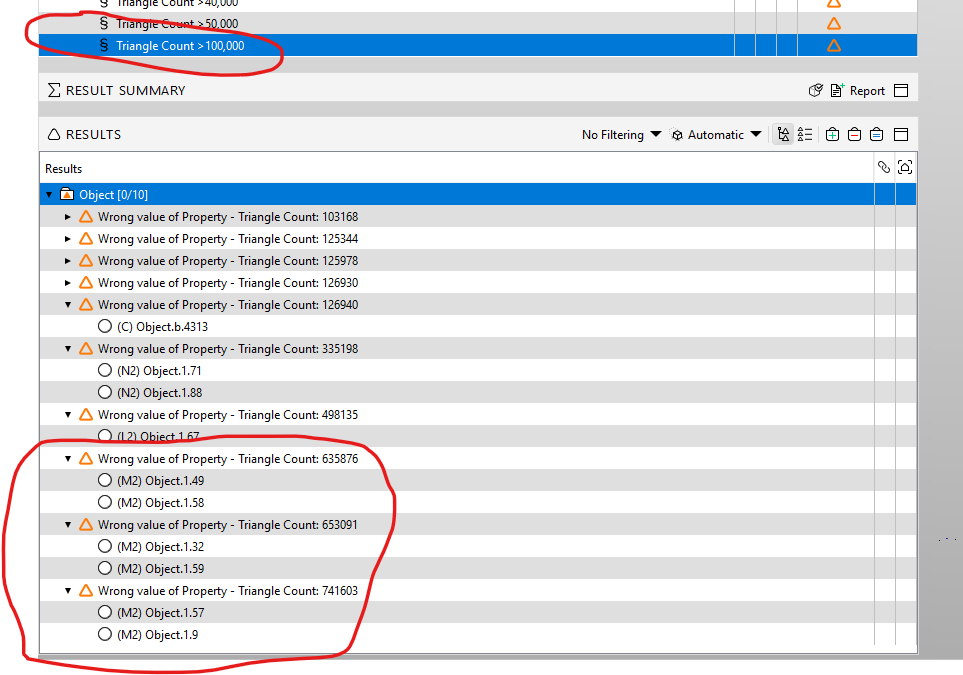

    Hi there,
    I am dealing with infrastructure models which are very large in size and slow to load etc. It would be good to be able to report on the “problem” objects and I have a Triangle count check that gives results but I would like to create an ITO which can report on actual objects with their triangle count (and the model they are from). Is there a way to access the triangle count as a parameter in an ITO? Thanks

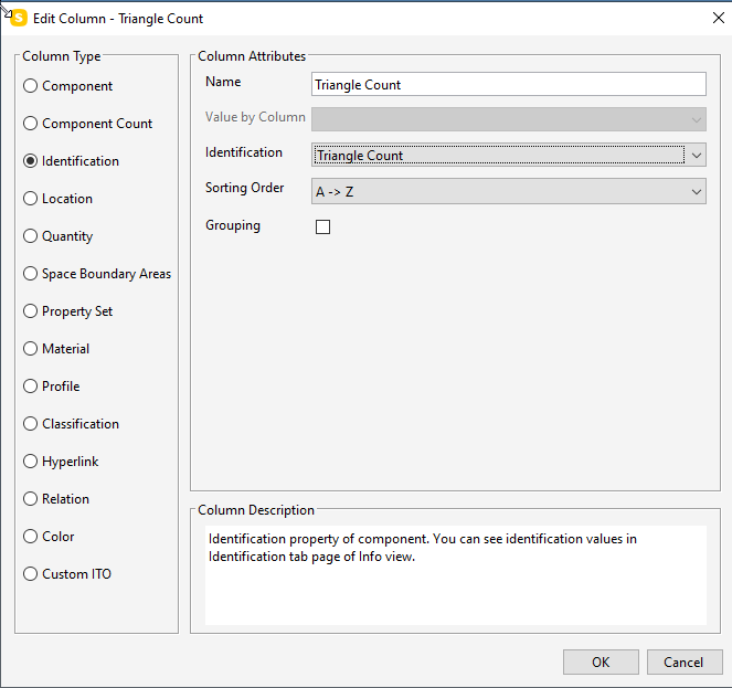

      @sfbeaz There’s a triangle count identification parameter available to use with the ITO’s.

        @mvandenbrink Great thanks
