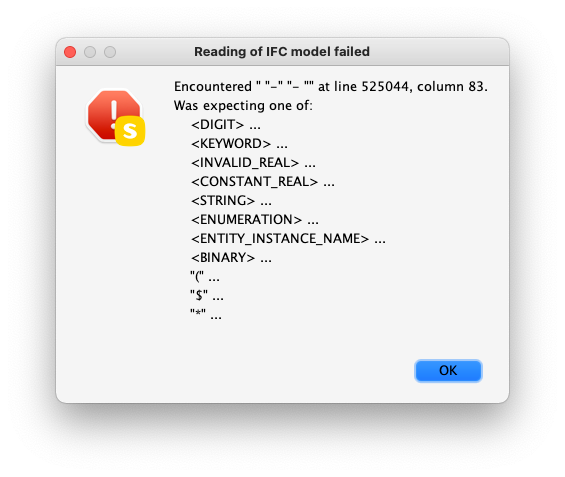

    I’m trying to open an IFC in Solibri that has been successfully opened in other IFC viewers (BIM Collab & OpenIFCViewer). Every time I get the error message below:

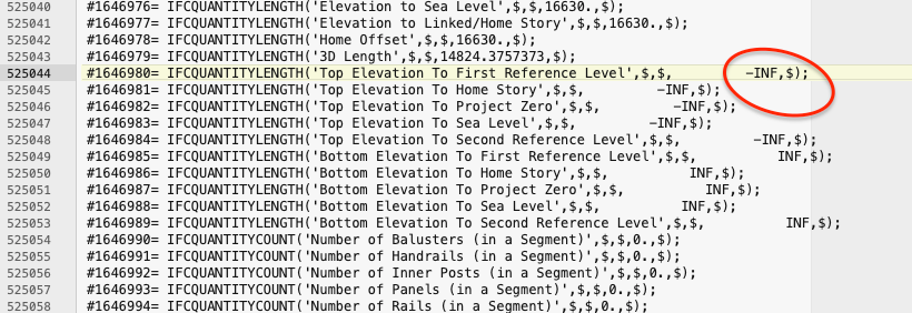

    When I open and check the file in a text editor I see the following:
    What does this mean and how can I fix it??
