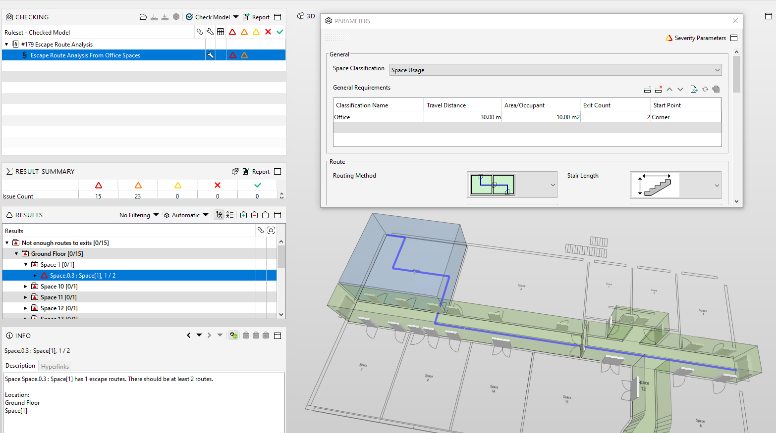

    I set the exit count to 2 in Rule 179 and it creates issues for spaces that have 3 exits. Why this happened? Thanks!
      lasse.lindqvist
      Hi. Do you mean the 3 doors the space has should be considered as exits? I think in your picture the door at the end of the blue line signifies an exit and the 3 doors out of the space don’t matter for that exit route. Essentially they all form the same route.
