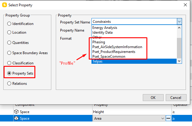

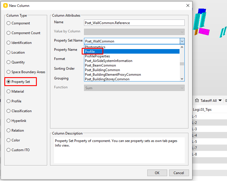

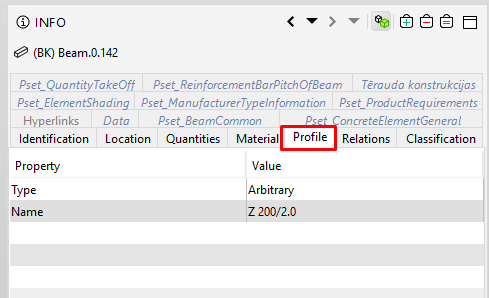

    I need help with checking property values, I want to compare two attribute values and one of them is to pick a value from the property set named “Profile” 8e7cf1d6-143e-4418-b8bb-5aacbb3db293-image.png
    but it doesn’t allow to pick it from in ruleset, just in Information Take Off:
    Information take-off:
    Thank you.

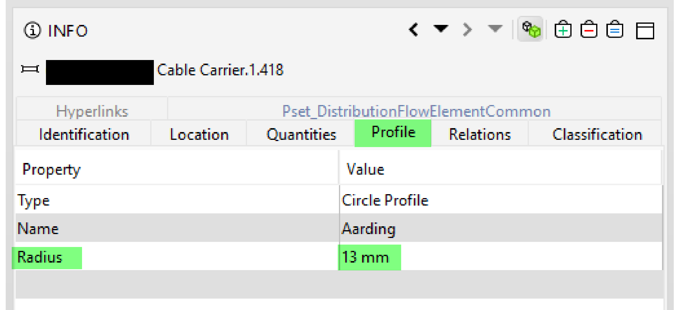

      I want to use ‘Radius’ in a classification. In the classification, the profile tab is non-existent.
      In Information Takeoff, the profile tab exists but the Radius parameter does not.
      @Solibrians ; Is there somebody who can tell us more about this?
      3
      • O Offline
        O Offline
        Ola
        @Solibrians Any update regarding this?
        This function would be really useful when checking voids, e.g. “Check all voids which type is circular and radius is >200mm colliding with concrete”.
        Also to classify profiles and sizes (radius, X dim, Y dim).
