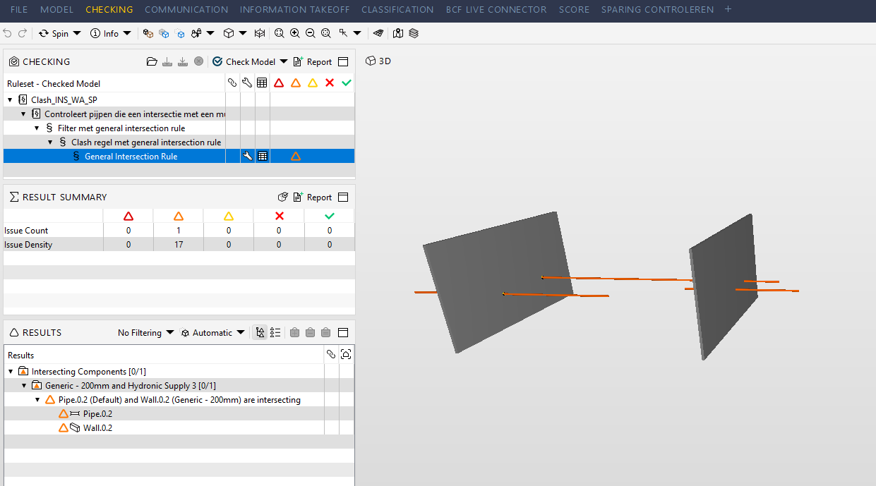

    Hi all.
    is it possible to get the location where two elements clash each other?
    the reason is that i need to know if there is a void have been placed where the pipe goes through a wall.
    i have tried the gatekeeper rules but it didnt work in all situations like when a pipe clashes with two walls…it needs two voids but because it has only one it get excluded from the clash.
    so i thought if i can get the location of the clash i can place objects at that location and clash it with all the voids in the project.
    sparingen_wanden_ins.smc

      Try to do with this rule-set, which should, atleast in mycase it did, help you.
      Best
      Test.cset

            it’s really important to have something like that.
            i was able to solve this problem using Dynamo by generating a small spheres at the centers of the areas where the pipe/duct intersect with a wall/floor and then clashing them with the voids. But it did’t work for big projects because it’s too much to the computer it takes hours to calculate and it freeze at the end. but in Solibri the geometries are different and lighter from revit and it is much faster. so hopefully something like that will be released soon.
