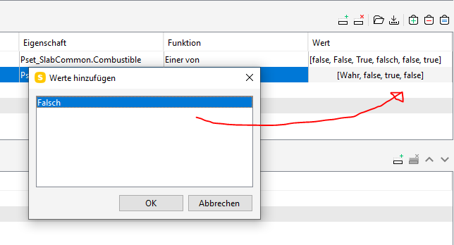

    Is there a reason why can’t see the data types of information in Solibri?

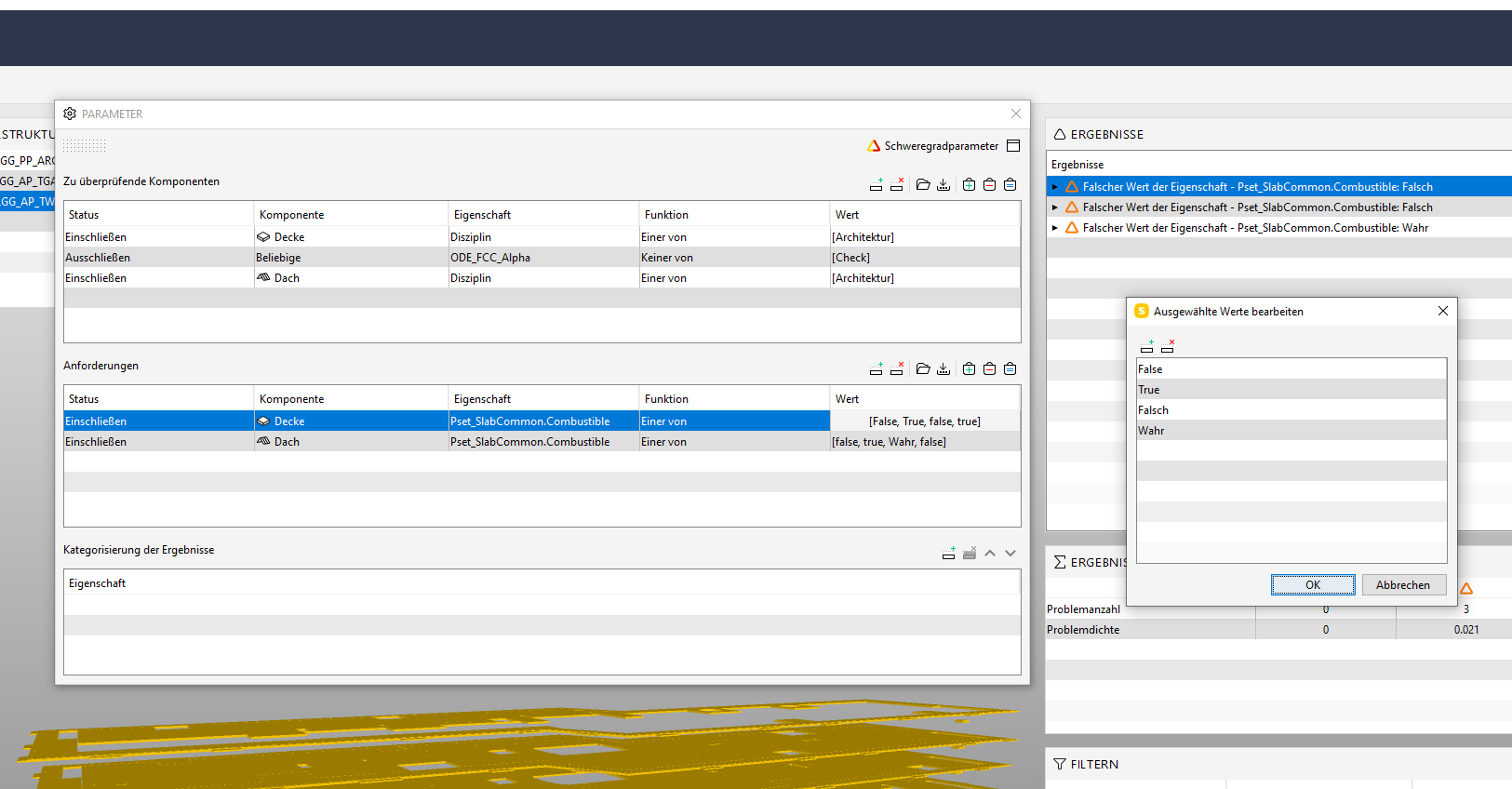

    In the following example the datatype seems to be wrong as the rule result says “Falsch” and “Wahr” are not allowed values for this property …
    Fun fact hower is, that I actually have added those values to the list but Solibri is kinda trying to get those boolean values right again and translates them accordingly …
    So yes the datatype is wrong … but actually even if I say labels are fine for me I can’t as Solibri doesn’t allow me.
    Even if I select “Falsch” via the drop down menu of the available values (which definitely is a label value then) it tries to convert it.
    So yeah, it’s right but on the other side it’s also kinda wrong.
    And again, I within solibri there is afaik no way to check the data type e.g. by hovering over a property (or an ITO column … probably this is possible via the API?) which let’s me crosscheck this quickly.
    As you can see I tried out different versions like writing in small and capital letters, so there might be a guideline how to make an “exception” for this behaviour in non englisch versions but I don’t know what’s really recommended.

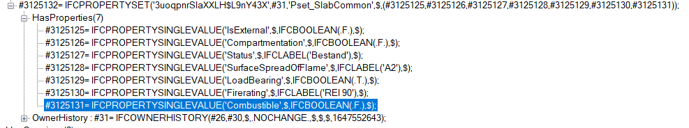

    The property type seems to be correct, now I am even more surprised.

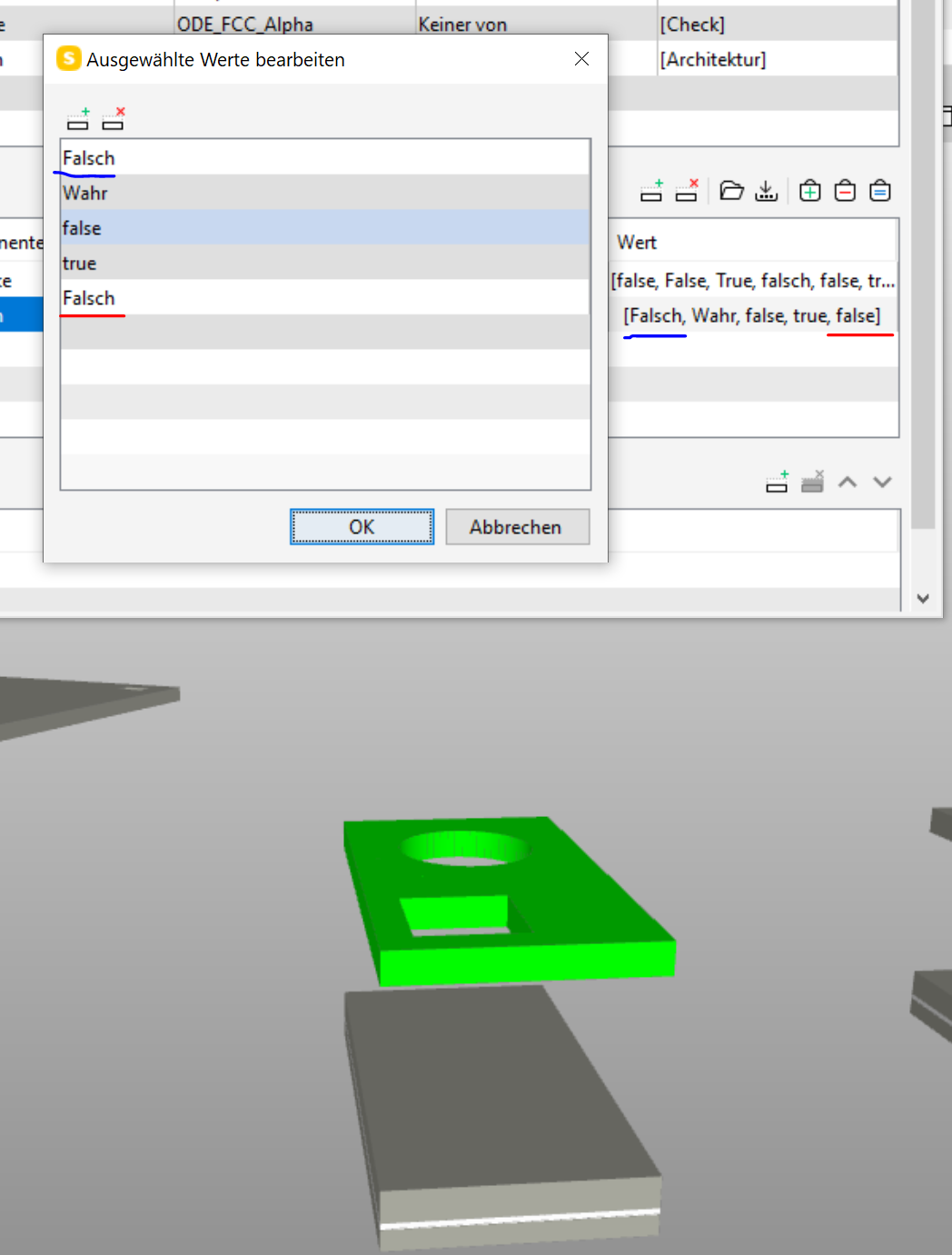

      Edit:
      Just realized that adding the values a third time seems to solve the issue as now it seems to work?!
