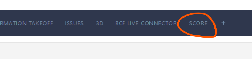

    The Score layout keeps coming back every time when I remove it and restart Solibri.
    I hope this is not intended to work like this and is a bug?
    Currentl running version 9.12.8.33
