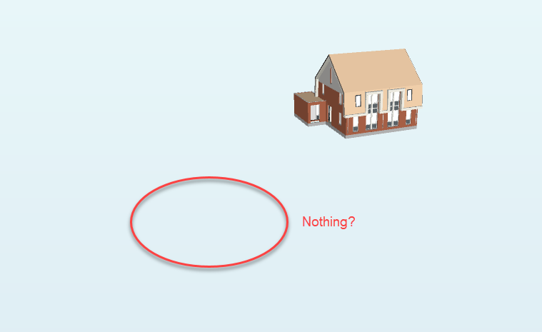

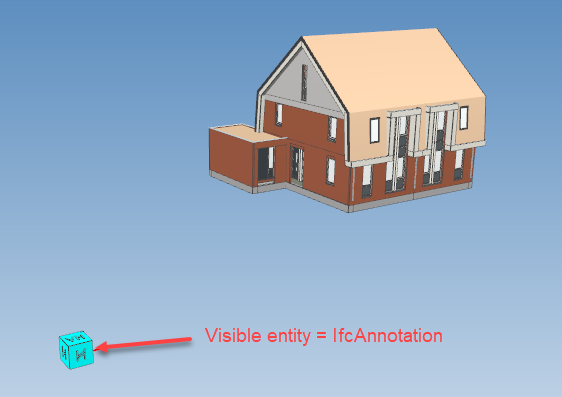

    Hi All.
    I have an IFC model, but in Solibri i don’t see the 0-piont (physically).
    In bimcollabZOOM I can see the 0-point.
    After lokking further I see the object is an IfcAnnotation.
    Any reason it’s not visible in Solibri?

      @sander-Eikelboom
      IfcAnnotations are not supported in Solibri.
      I added the information regarding this society post to the existing enhancement requests in this regard.
