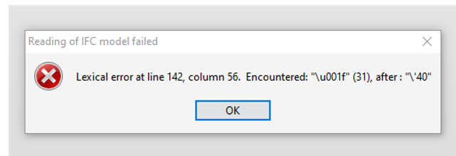

    We have problems with opening IFC models and get this remark. In other software there is no problem (BIMvision, BIMcollabZOOM) and we have the latest exporter in Revit (where model comes from). Also the remark Solibri makes, is not to be found in the file. Can anyone help us?

      Hi. Most likely your IFC file has faulty structure. Some tools might ignore these errors and try their best to read the contents, but it is possible that they then lose some of the data. You could look at that line on the file and check if is syntactically correct.

        The FZKViewer has a IFC Scheme validation function. Maybe that will give insights on what exactly is wrong.
