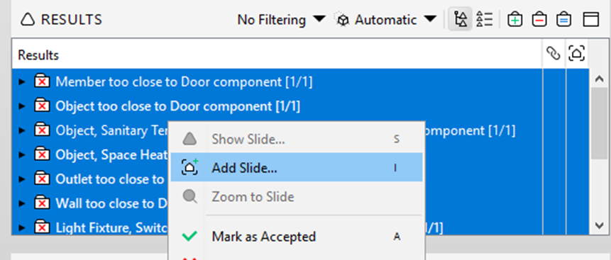

    I have found potential bug in Solibri.

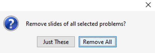

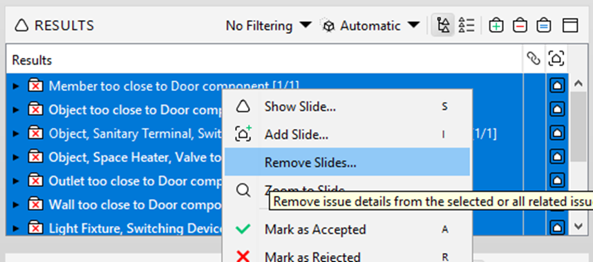

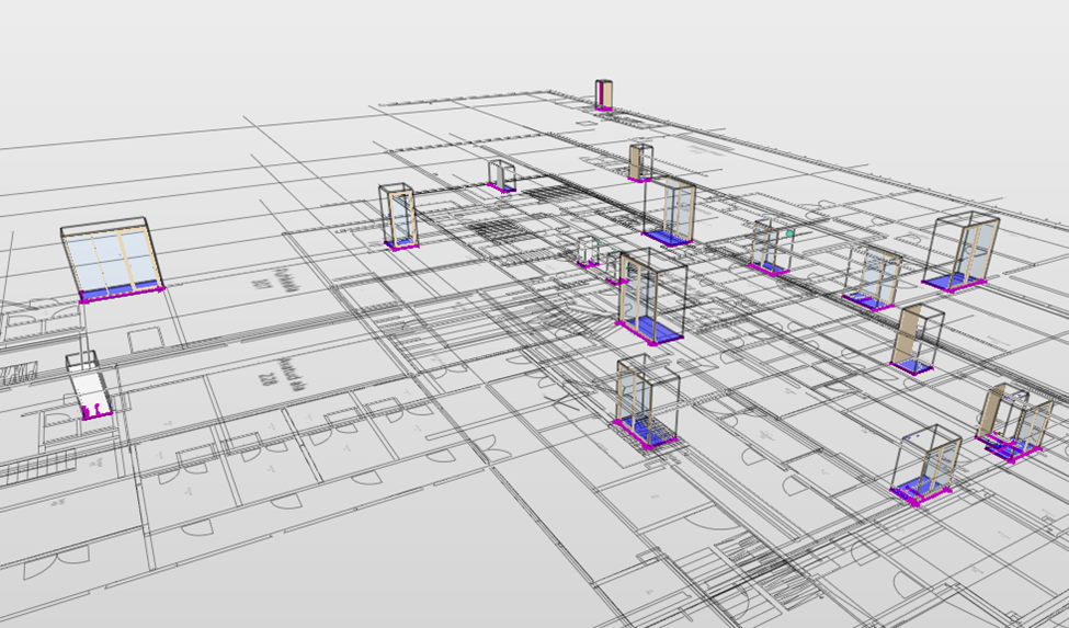

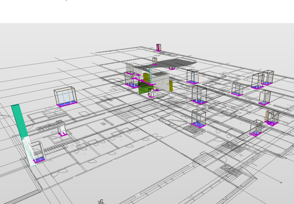

    At the moment I can not update presentation (made from checking result) issue slide view. Only way that I have found to update slide view is to remove slides and then add slides again. Is there any better way? It would be good if it would be possible to add new slide to issue so it would be possible to see progress.
    Initial view

    View has changed

      Hi. Does it happen for you only when creating slides for checking-result-groups? This could behave differently in Solibri 10 as the internal logic has changed a little bit there.
        lraimo
        This happens also when I make slides from checking results.
