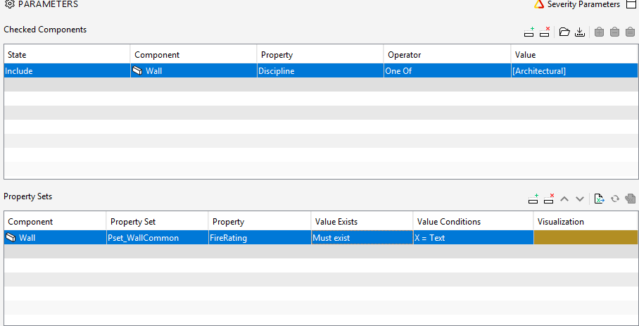

        CarpgianeDS
        Hi Thanks for your reply, I’m only getting to grips with Solibri this is how i’ve got the ruleset set up but with no positive results.
        • B Offline
          B Offline
          BIM1337
          Is the Property Set correct?
          The value conditions is searching for text?
          Try this, it’ll search for any value. If it’s empty or the parameter doesn’t exist you’ll get a result.
