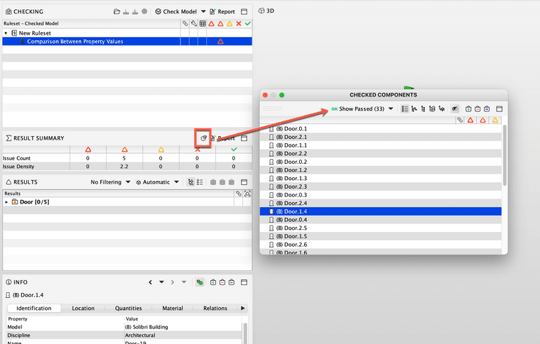

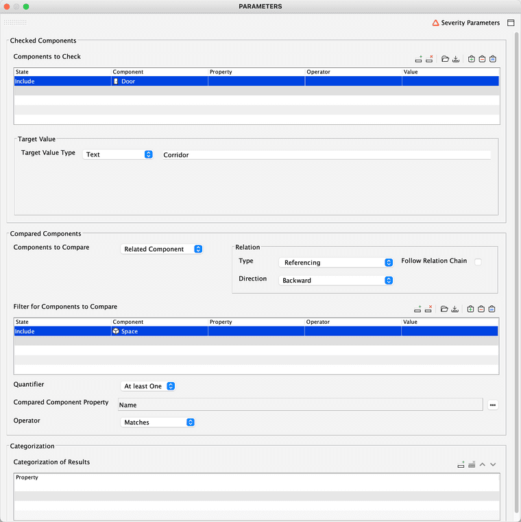

      Setting the first filter to Doors, and setting the Target Type = Text = Corridor (for example) - This is the value in the door you will be looking for later. Then in the compared properties choose Related component and in the relation set the type to referencing with a backward direction. Set the filter for components to compare to the spaces, then set the quantifier to “at least one” set the compared component property to Name and then the operator to Matches.
      See image below, this will produce passed items for doors with the matched value. You can then use these elements in a subrule with the gatekeeper functionality.

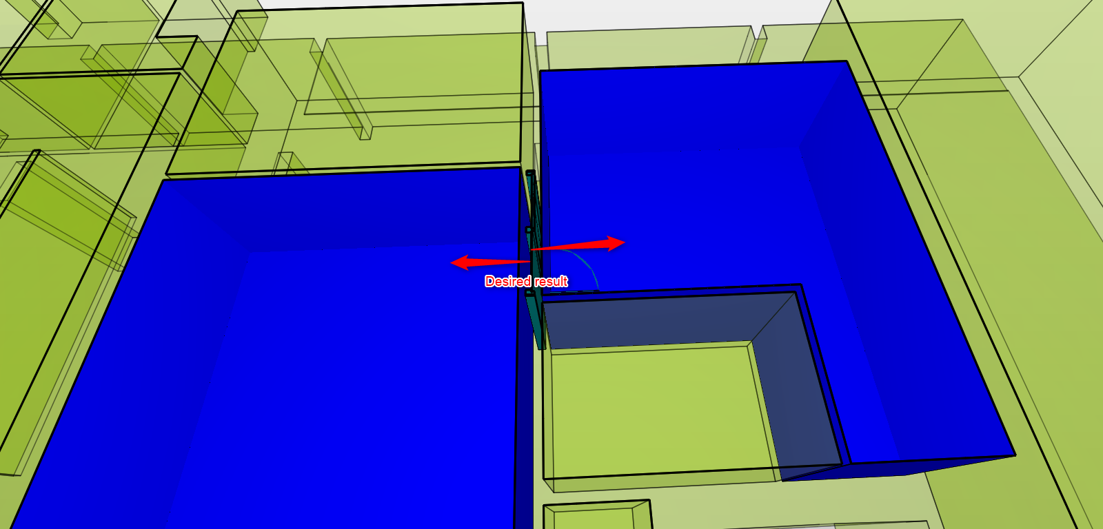

                alt text
                This is basically the outcome I’m looking for. A clash result containing the door and the blue spaces on both sides of the door.

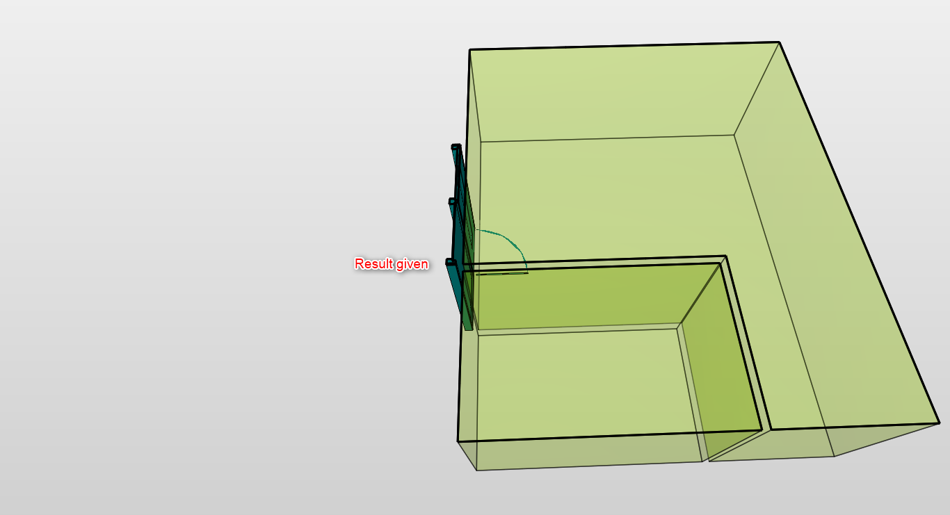

                Using rule 231 it will sometimes give a result that contains one space that is correct, but the other space will be the one next to the door, instead of the space pointed at by the arrows in my screenshot. Like in the below image.
                alt text
                I noticed changing Relation to Nearest Spaces Direction Forward produces different results in rule 231, but still not the output I want for all the doors.
                This is why I want to use rule 226 and just need it to detect the spaces as an object that isn’t allowed in the area near the door, then I will have my desired outcome, kind of like this:

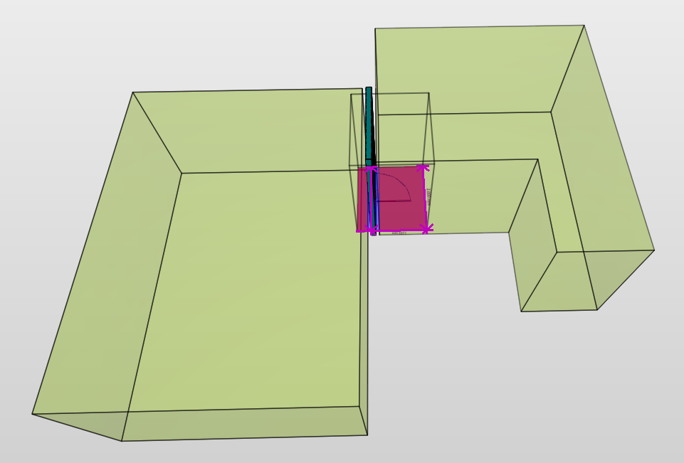

                    Does Component Distance work to check a door within 1mm of a Space? This will allow you to control the allowed distance to be considered (rather than relying on the nearest space algorithm).

                      Already tried this, it’s like I said in the earlier post. It’ll also give results with spaces next to it if that’s closer than the space in front or behind the door.
                      So that’s not giving the desired results.
